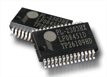

    Please tell me where and how you can buy pl2303, I understand that if I buy a chip pl2303, then it will need to flash or to have ready for sale?
    Please reply.

    many electronic retailers sell them
    they are also found in thousands of brands of USB-Serial convertor cables. Most people will have one and not even know it.

    Does it need to be flashed/modified in any way or will any PL2303 do? Don't want to all the soldering work, only to find out it needed programming...

    Tell me I changed pl2303, but it is defined as unknow device and driver ck3i not like. Is there a difference in the labeling pl2303 (hx, ta ...)?

    I replace PL2303 and at anykind of windows version, it just show me Unknown Device...
    i still can use CK3i without any USB (manually)

    Sorry for bumping, has anyone had success in getting it recognised after the replacement? I'm interested ion replacing it, but I only want to if I can get it fully working after.

    I'll repeat the question if we replace the part ourselves or get someone to do it does it need programming?

    It doesn't need programming, simply solder it in place (ensuring you install it the right way - a dot on the chip will indicate which way it goes) and away you go.

    I have some problem . Need program chip . It have different hardware id and driver not support it.
