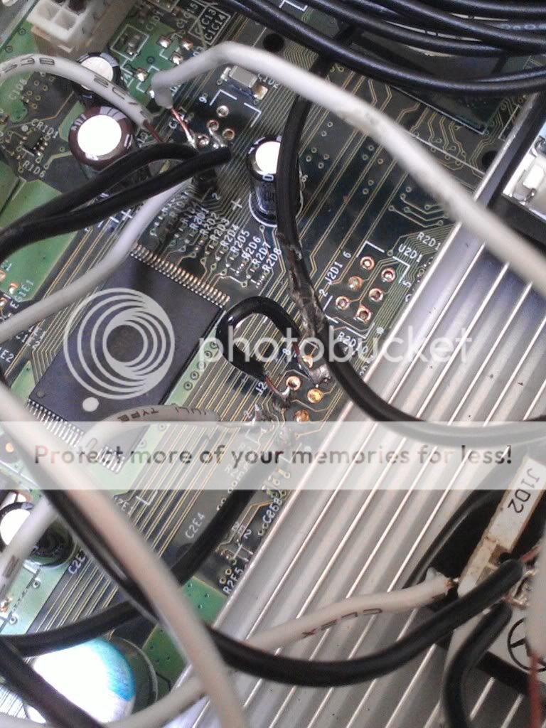

ignore the soldering its not mine lol but i use this method on xenons that give me grief
---------- Post added at 08:27 ---------- Previous post was at 08:21 ----------

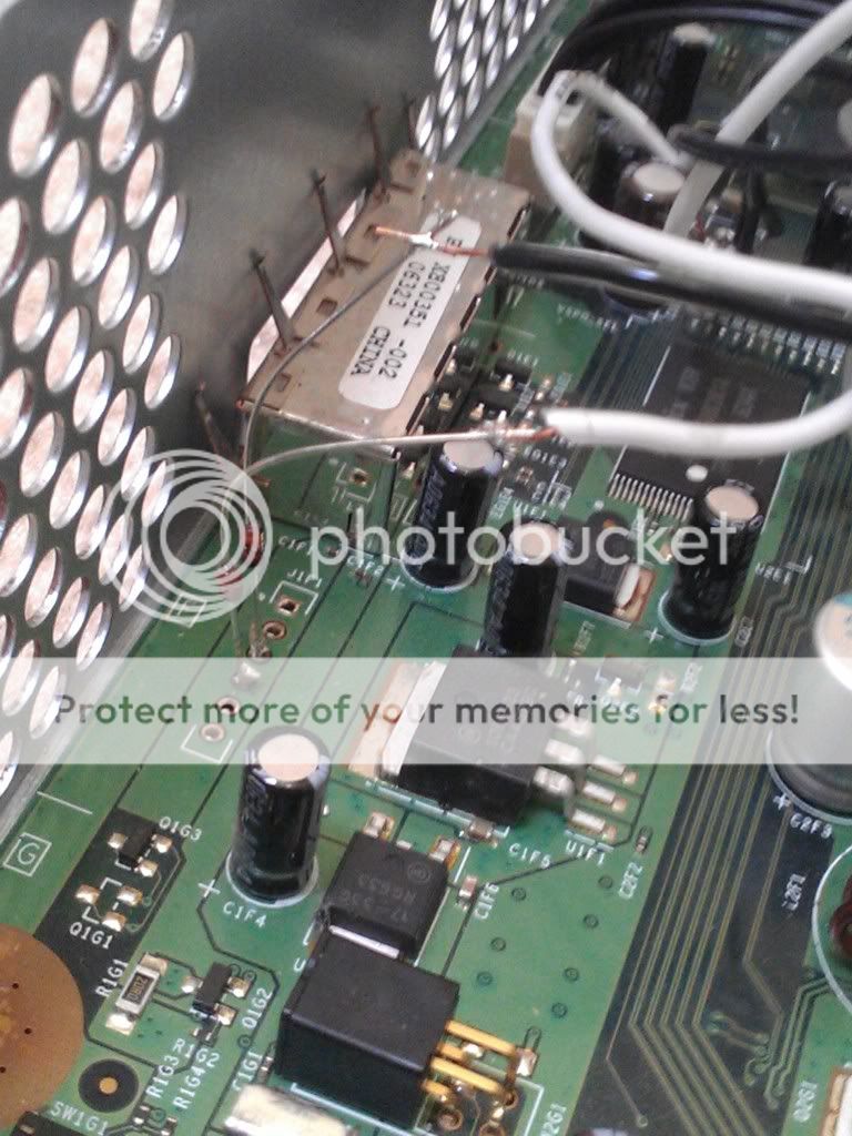

but as tivi states clean up your soldering you have alot of overspill on your joints too much solder in places
---------- Post added at 08:28 ---------- Previous post was at 08:27 ----------
it looks like two things your holding the iron on the wire too long and getting drag and not enough flux

Close ups (and in focus) pictures of the immediate areas where you have soldered on the motherboard. We need to see if you lifted or fried any caps or resistors.
In short it boils down to 3 possible issues for the 0020/0021 when you try it stock with NOTHING soldered in:
1: Bridged solder points
2: Fried/missing components
3: Gpu/ram needs a reflow
