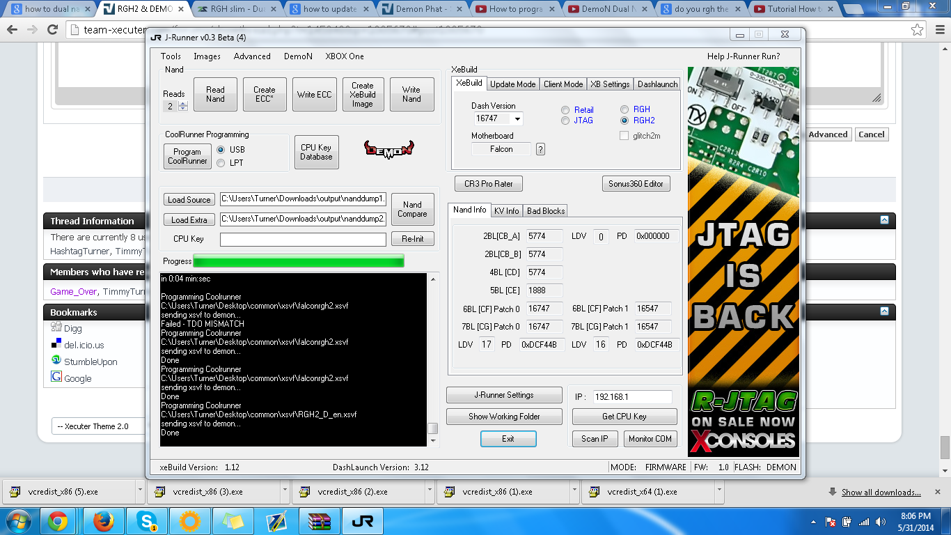

Ok so today was the day I brought out the old demon and decided to install it to my retail along with a cool runner rev c. The dashboard is on latest 16747 and I went ahead and took it apart and watched a tut on how to do it. I first got my nand x and read the nand before anything and it was fine. I checked my demon chip to see if it worked and it did so I switched the toggle switch back to xbox360 and soldered it and the wires in place. I flipped it over and installed the cool runner in the rgh2 format. After all of that I put it back together an plugged the power in and connected the micro usb to the front port to my computer and read it on J-runner. I get this error :
Saturday, May 31, 2014 5:14:18 PM
J-Runner v0.3 Beta (4) Started
RGH2 Selected
Retail Selected
RGH2 Selected
Current: DemoN
Switching to XBOX
Retail Selected
Reading Nand to C:\Users\Turner\Downloads\output\nanddump1.bin
XBOX360
Cancelled
Current: XBOX
Switching to DemoN
DEMON
Hardware : Demon Phat
Firmware : 1.0
Flash ID : 0x73AD Hynix (16MiB - Small block)
Flash Size : 0x400 blocks of 0x4200 bytes
Reading Nand
in 0:23 min:sec
Initializing nanddump1.bin..
Header is wrong..
Please help :) Thanks
