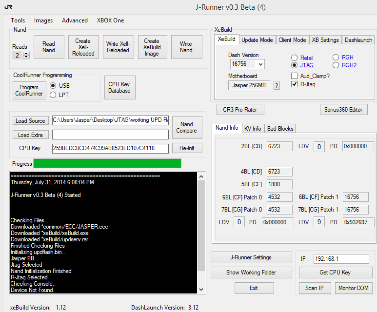

Screenshot of NAND details from J-Runner:

It appears there were a few bad block, but nothing that made the 360 not function correctly. Nand wrote 100% and booted fine.
