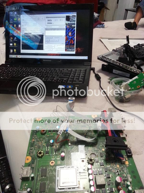

Is a slim e with 250 hdd....ill open it in like 30 mins...im trying to wire since on the past i had bad luck soldering qbs boards lol so i find wiring easier i dont mind doing the extra points if i have to i can just wire the qsb upgrade board then see of it works and lay the cables around it....also i know the yellow from cr goes to postfix but the blue one still goes same point under x clamp??

finished wiring the rd/wr kit and successful reading the nand so far, hope finishes ok
update : finished reading nand with no errors at all, doign second rad, nand size 3,784,704 KB ? is this correct ?

That's the correct size for a full 4GB dump, however you only need the first 64MB. You can continue as you normally would.
gah i did full dumps, should i do regular dumps instead and just treat them like a regular dumps ??
update : regular dumps only dumps 49,152 KB is this correct too ?

If you want, create another dump (with a different filename) and keep your full dump as backup. Of course, you can continue on with your full 4GB normally. The choice is yours.
Jul 19, 2014
202
Sunny Florida
As long as you have multiple NAND dumps that are identical, either will work. Since you already have full dumps, use those. The NAND RW Kit read/writes quickly anyway, so it's not big deal.
