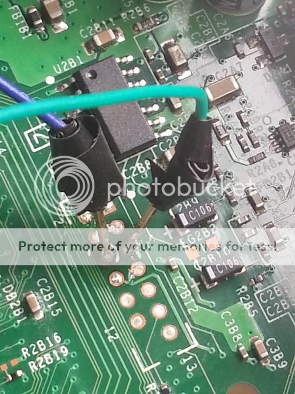

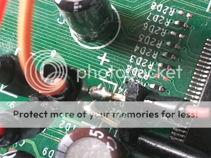

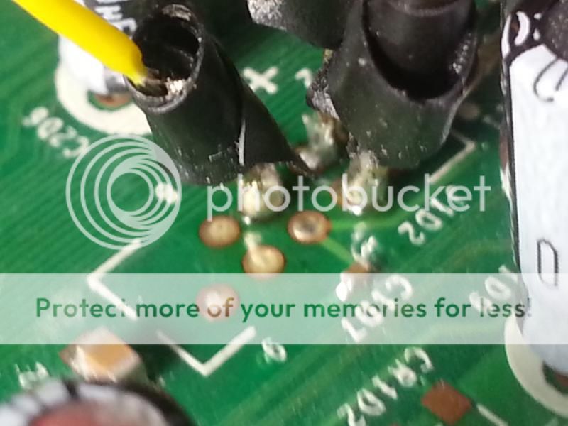

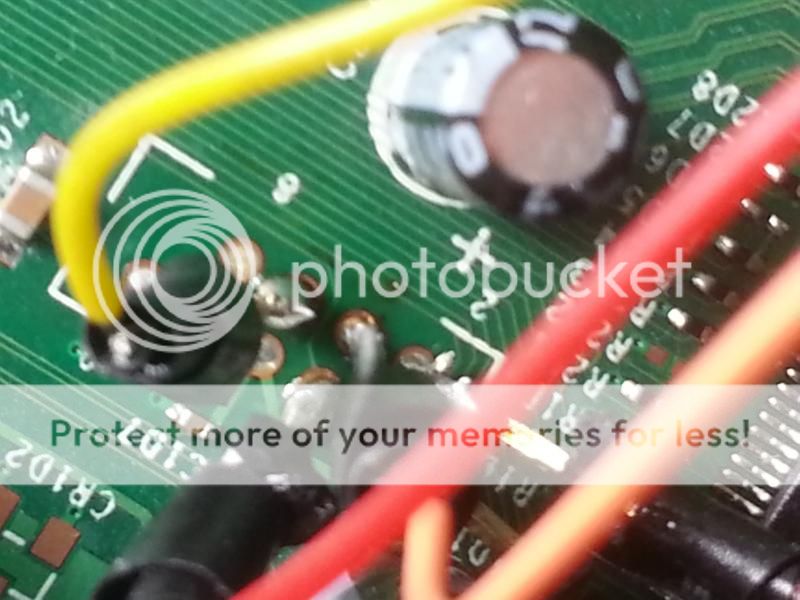

im trying to dump this nand for a jasper and im getting 2 bad blocks, seems J-R is remapping them as per 360 Falsh Dump Tool v0.97, am i safe to continue with RGH process ? i double check soldering (im using pins and check with a magnifying glass for bridging) and seems ok no bridging anywhere....ill post some pics ans J-R log maybe anyone can advice.

don't continue redo your soldering and try again
and jrunner doesn't recognize block 372 as remapped but the other app does, ill try to resolder and see
update: desodlered everything and soldered back and got same 2 bad blocks 2BD and 372 but now it says nands are the same, so im good to go then ?
