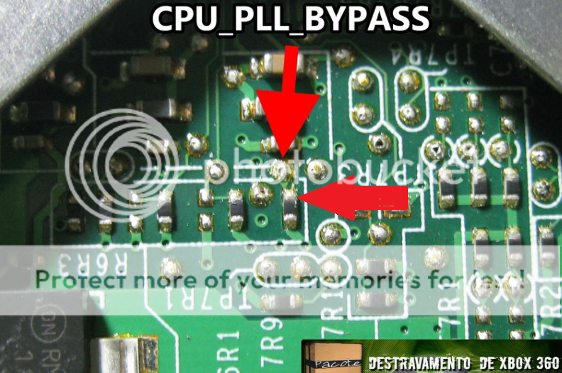

RGH Alternet point for green wire

Simplest point there is, use flux and just add a little little tiny bit of solder on the tip of the iron.

yer there is another point but it is under the heat sink on top best bet s find some dead pcb controller or what ever you can get and play with that til your upto the job ..what iron are you using and flux ??
