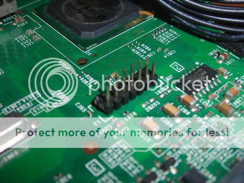

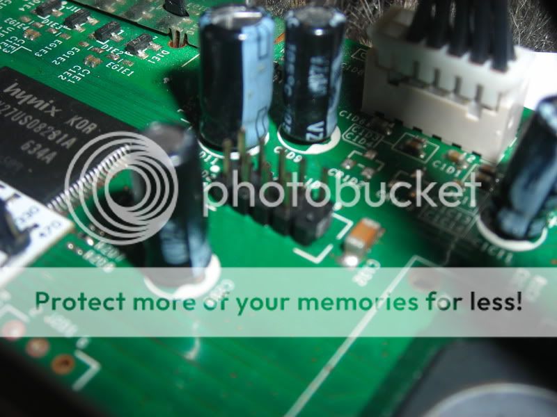

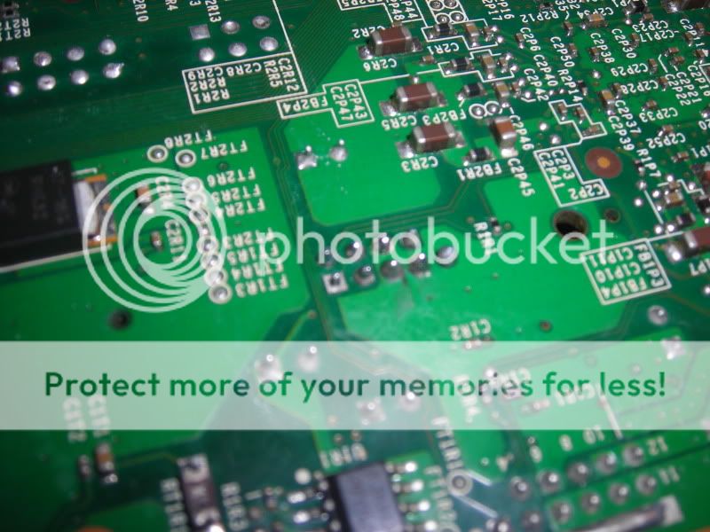

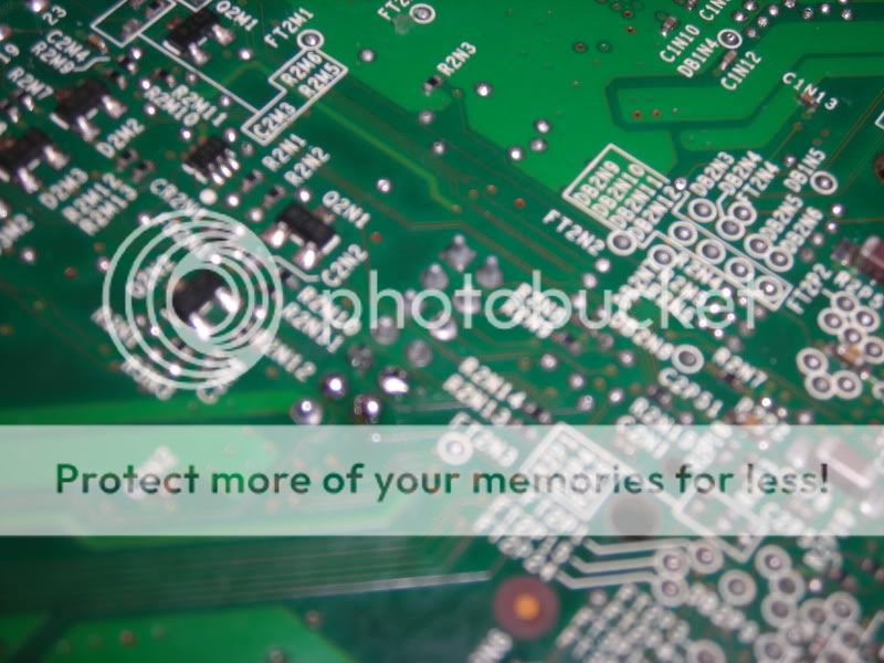

Managed to dig out the camera,kids broke it some while a go,doesn't focus to good :frown:
Jtag qsb's
Pin headers from underneath
Anything look out of the ordinary here?
