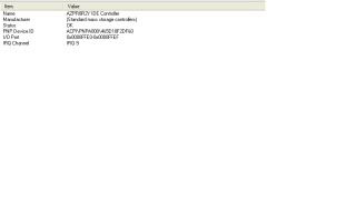

My current situation is this: Old Xbox 360 Arcade or w/e. Bought a Hard drive later down the line to get on live. Basically it's the oldest, cheapest xbox there is. It started to make the infamous grinding noise, which I think is because of a motor or something (not the magnet), and eventually completely stopped reading discs at all. Now I am looking to replace it with a new DVD drive, and at the same time flash this new drive to play "my backed up" games.
I just opened it up to check, and the drive says f/w=ms28 on it. So I have a Samsung MS28?
I have two questions, first: To replace it, I get an identical Samsung MS28 drive, correct? And what chipset do I need to be able to flash it with JungleFlasher? Here is a screenshot of my chipset info screen--I'm not quite sure what I'm looking for if anyone can tell me if this is sufficient.

can not read any of that screen shot post a bigger picture.

Sorry, I didn't notice that. Don't know why Photobucket cut the pics down more than 1/3 the size. I can't get it to not post tiny pics, so I'll attach them.

It's should read fine, try it before ordering a via. Once you have the original fw spoof it with whatever fw you want & that well work on a new drive. Also the drive my just need to be cleaned & you can just swap the pcb of the two same model drive's.
