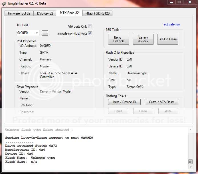

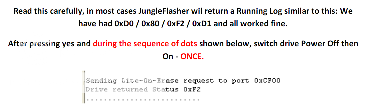

Before hand, yes I am sorry for posting this in a new topic but no one will answer my old topic.
Can someone please explain what to do during this phase?
Thumbnail; click to expand
Is this telling me to unplug the black/white cord and plug it back or what?
Every time I do this I get drive intro device failed.
I do not have the power dongle. Only the USB xtractor.
This is what comes up when I do not power cycle my drive.

I think I destroyed my drive. It will not read any discs, not normal, a backup, or a DVD.
I looked on google and I found people saying that there is no way to undo this. I reverted back to original firmware, updated. Nothing.
If anyone has any suggestions, please post. I pretty much lost hope after reading that my drive may be dead.

Which version of the Lite-On do you have? Has it been flashed before? Have you tried just sending a write command? It looks like you successfully erased the drive. I assume you got the key first?

Yes, I have the key and everything needed.
Just that with this firmware it DOES NOT read discs. I looked on google and I see like 3 or 4 people had this same problem. They went back to 1.61 and it worked fine. I plan on doing this.
Just that now I get the Intro device Error when trying to send the erase command.

Thats the thing though. I get the same error when I try to erase the drive. This isn't trying to write to it yet.
As the Jungle Flasher guide says.
I must power cycle my drive. Yet this seems impossible to do without a power dongle. Which I can not buy.
The weird thing is I got it to work once.

Just power cycle, and send an Intro.
This will bring up good flash chip properties and you can write to the flash chip.

all you have to do is send intro device id again wait for the dots to appear then power on the drive
now you can write to the drive
