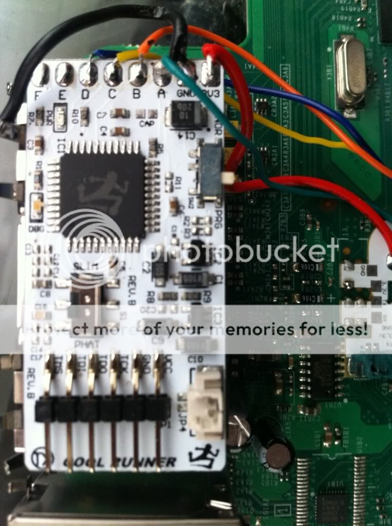

So i installed the COOLRUNNER rev.b on one of the BB Jaspers. The red light on the coolrunner did not come on after i flashed the new nand. I checked the soldering and wires to make sure they were okay and the light still didnt come on. I unsoldered the coolrunner and installed a different coolrunner. Not sure if it was a soldering issue on the coolrunner or not but the red light now comes on, however the Xbox now has 3 red lights flashing. Whats the problem and how can it be fixed?

You will need to get the secondary error code first.
Also how long does it take before it gets RROD? Does the green light blink every 5 seconds?
Have you tried flashing back your original nand and see if it RRODs then?

when you say the CR red light would not come on, how did you wire it up? this must have been very wrong for it not to illuminate.

Well the CR powers up now after i did some rewiring. Im assuming that after i took to the CR off and replaced it with another CR, it screwed something up. Light on the PSU is green when it is on.

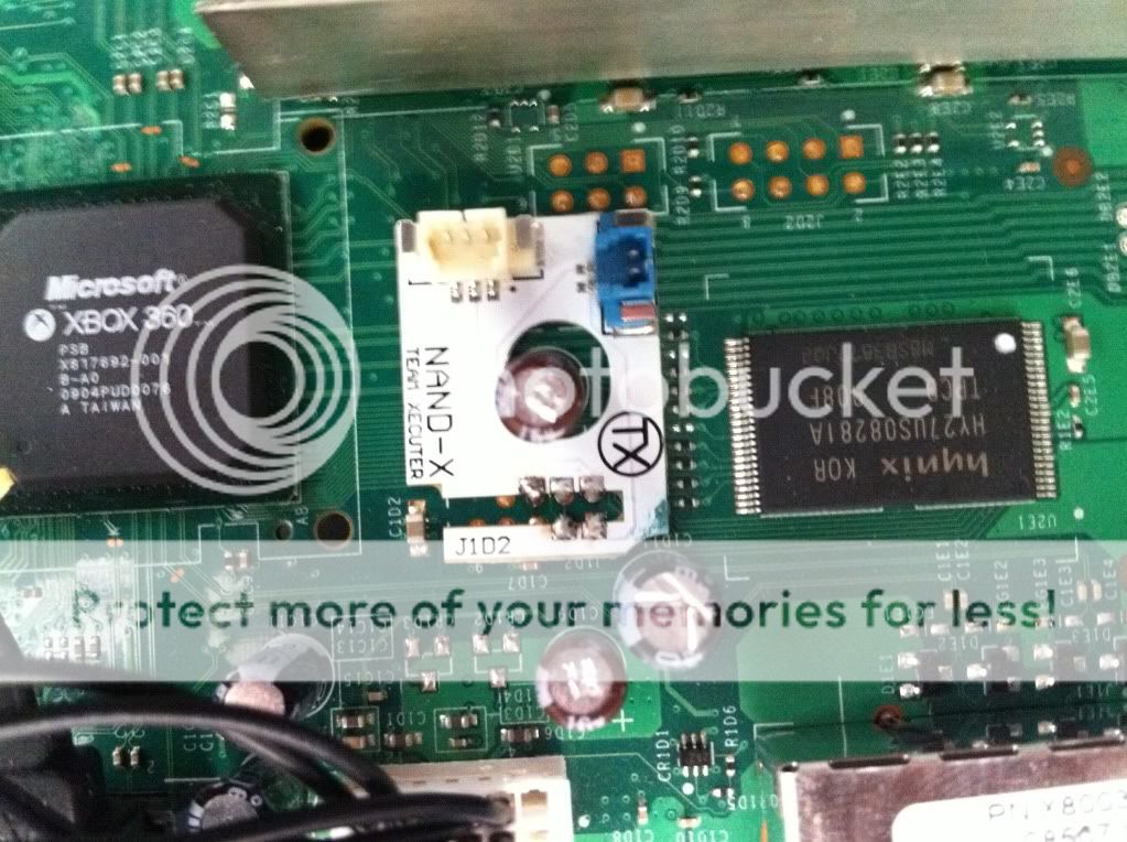

Put some pics up and you will get some help

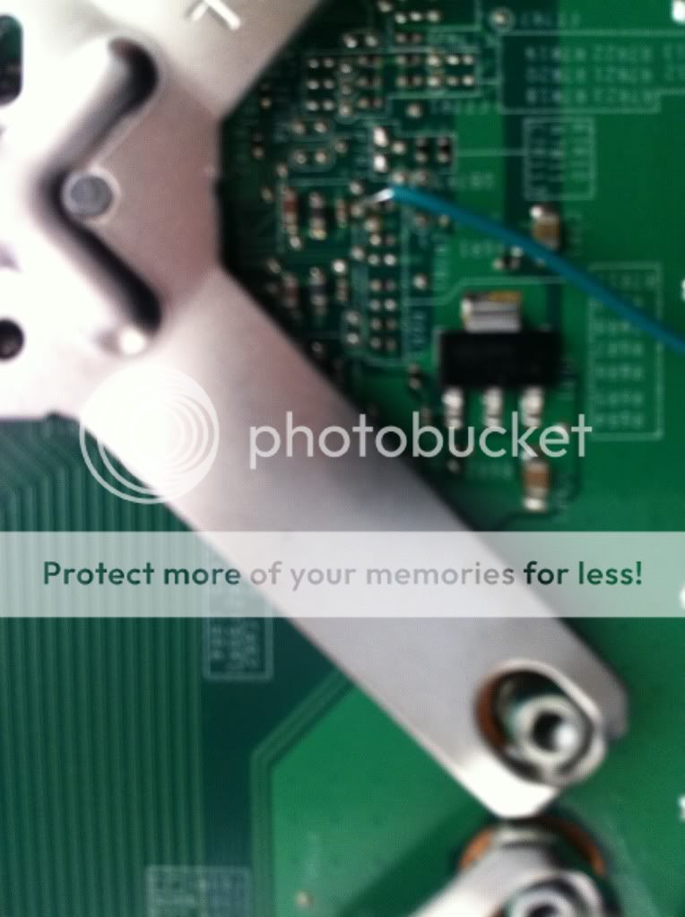

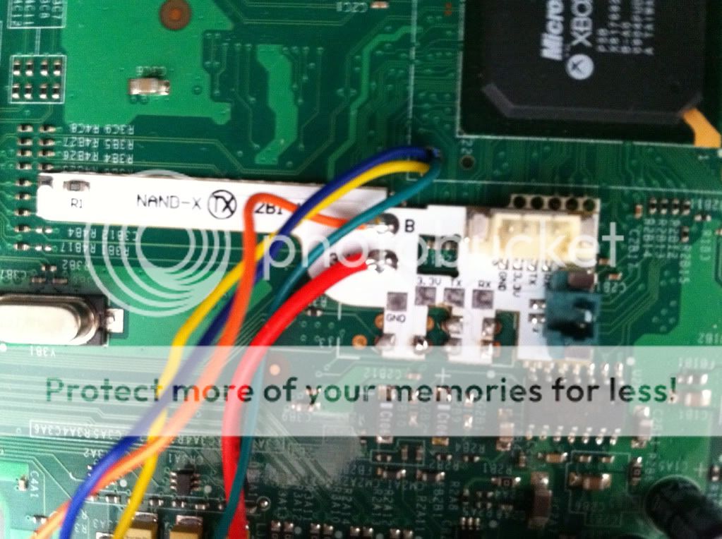

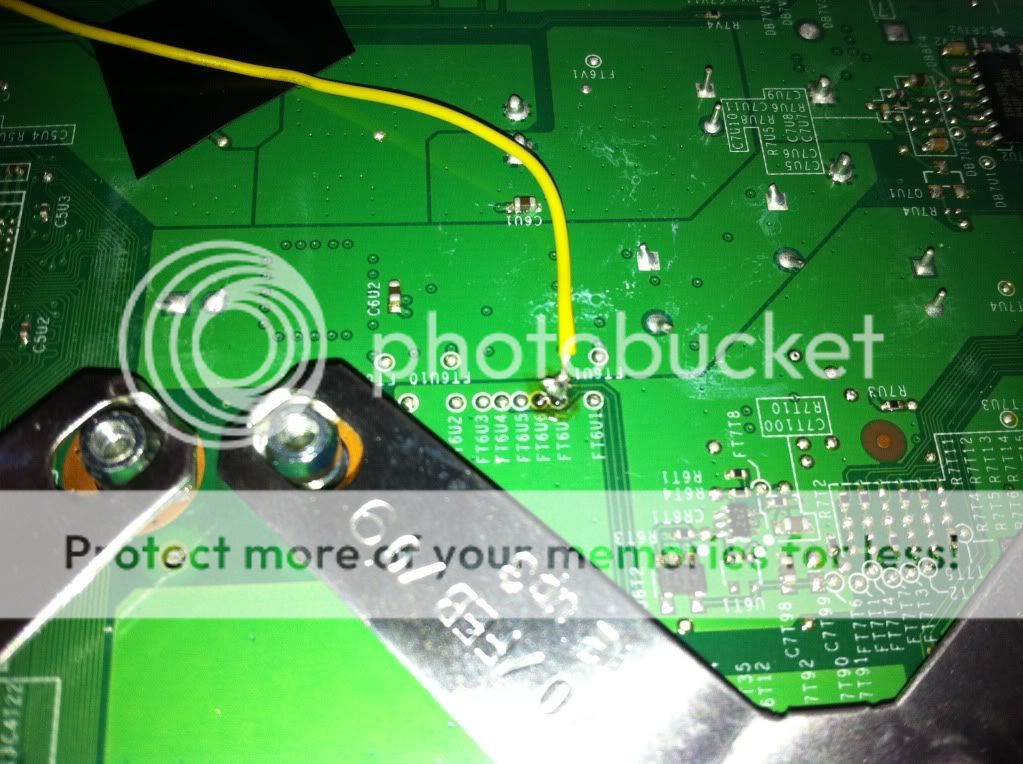

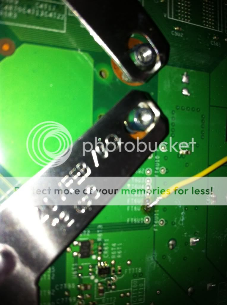

Here are my photos
Im assuming that its being caused by the FT6U7 area (yellow wire) thats causing the RROD. Need some expertise on this.

Yes, original nand has been flashed back and ive tried unsoldering the CR, but not the nand-x QSB
