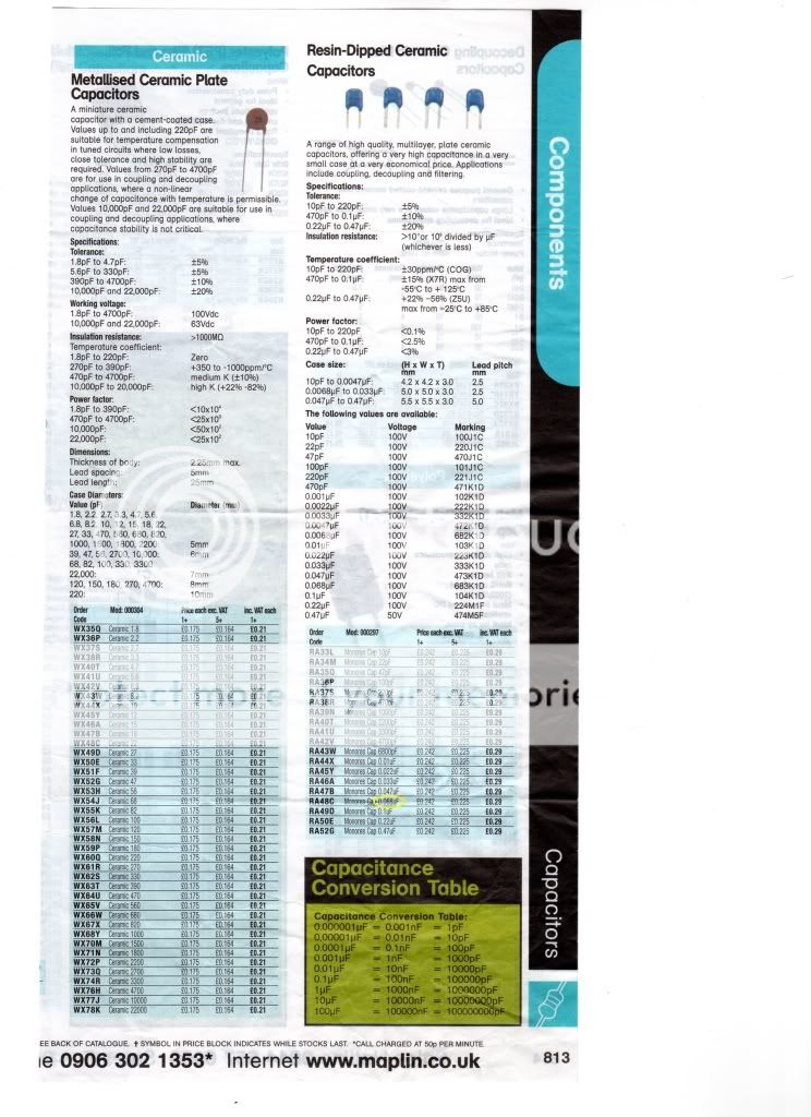

Don't you mean a 68nF (0.068uF) ?
and it should have made any difference at all adding one to CPU_RST - did you test for any difference ?
Yep sorry it was (0.068uF) It was the exact same cap that seanr28 used from maplin.

Can one of you guys point me in the right direction to grab some of these?!?!? I'm in the US. Could not find the. At RadioShack!!! Any help would be appreciated.

very very interesting post
just ordered a load from maplins now just to have in case i come across any of these issues
really appreciate it alot guys thanks your new grey hairs have saved me alot of wasted time
I don't know where you're located but I bought them in Fry's Electronics, they even have them online.... Hope this helps
