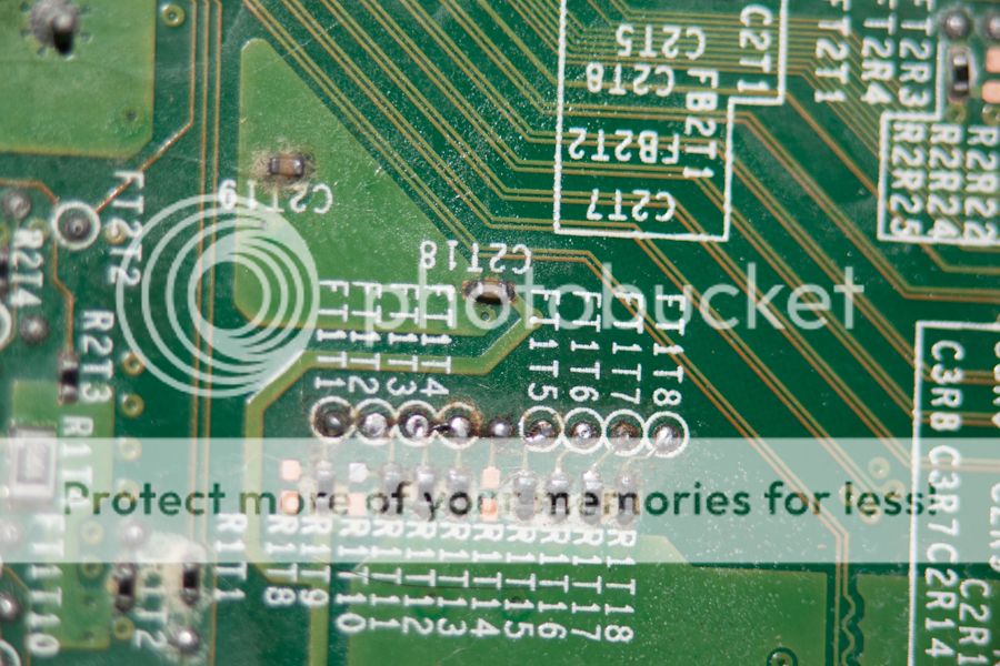

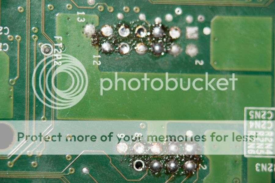

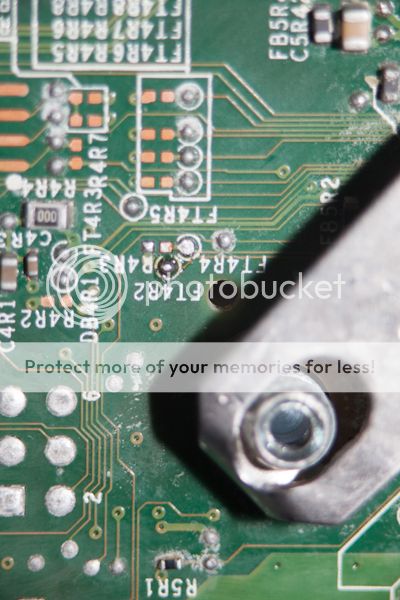

I have damaged a couple of points taking a demon off.
FT1T1 and FT1T7 I think or one or the other.
any got any ideas how to fix it?
here is pics of all the points
Link To Image
Link To Image
Link To Image
Link To Image
Link To Image

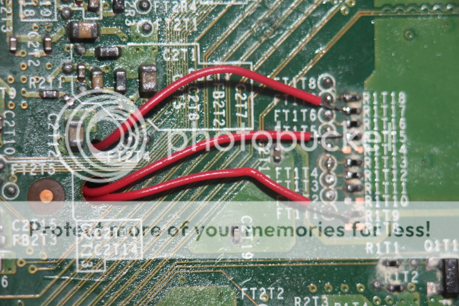

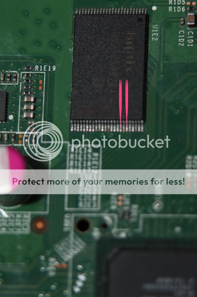

turn board over and look at nand chip,look on right side of nand turn it with letters reading right side/way up.ft1t5 goes to 8th pin on right side of nand down from top right
ft1t7 goes to 6th nand pin down from the top right

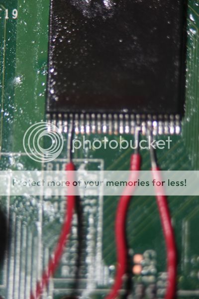

jus run some strands of kynar from the corosponding resistors by the points on backside,to the nand pins.
sorry,ft1t1 also goes to the 5th nand pin up from bottom right side of nand
do you mean these pins?
nofeloniesyet
Jan 16, 2011
4,830
Nowhere
so the 5th one in on the left on that same row?

see my last post,i edited pic for you
Between the demoN slim install images and plentiful images of the 360 NAND layout, you should have everything you need.

after I re route these points and its still the same, what else could it be? or is it pretty much certain it is
if redoing those points i showed you dont do the trick you will probably be better off sending it to martin c

take a mm and see if you get cont on any of your nand pins on ft1t3
13,721
It would have probably been easier to do a continuity test first.
Check that each IO resistor (the D0 points) has continuity with it's correct solder pad and use the NAND pins for those that don't have continuity.
Have you also checked that STBY_CLK (R3B15) is fine?
