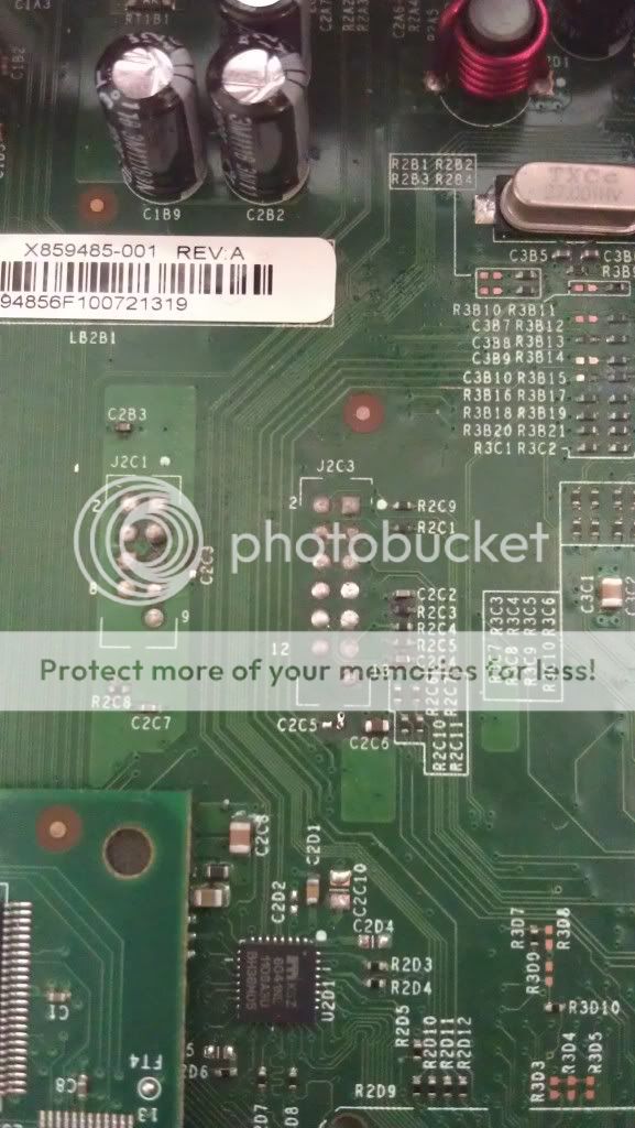

But first the problem I think with the console not turning on is the component at C2C5 is missing. no idea how they did it but they have.
However there is no damage to any of the points used by the coolrunner. The STBY_CLK is intact which is what i'm used to repairing.
So my big question to someone who actually knows. What is the component at C2C5 below the points used for the NAND-X so i can use a replacement from a broken phat console. or order a new one. Just don't have a slim to look at myself.

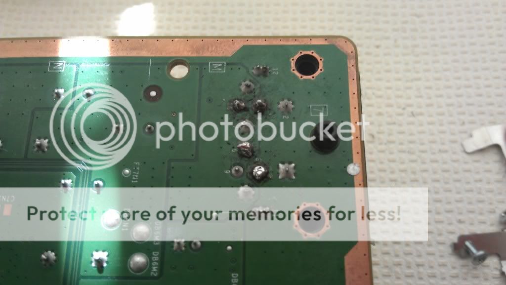

Also for some reason they have soldered the points that connect the power adapter plug to the console. They're a bit big for practiceing with? Seems F*&%ed up to me.

Header Points:
STBY_CLK: (looks clean and tested with multimetre)
Power Socket soldering: (WTF!!)

looks like one resistor is missing on the STBY_CLK, other resistors may be damaged but thats why its beeping and not booting, for a decent modder its a easy fix but for a novice it very difficult. i would send it away for repair if thats an option. Chances are if the STBY_CLK point is messed up then he possibly didnt get as far as reading/writing the nand. Use a multimeter and check to see if any of the other resistors have been damaged. I usually rob the resistors off ruined boards, I believe its a SMD 330 ohm resistor but double check it first. best of luck

Just an update on the actual repair.
Got my own slim back ripped open the console determined the missing components were diodes. And have found replacements however...
I Need to find an alternate point for C2C3 as the pad is gone, and soldering to whats left is going to be impossibile.
R2C3 also checks out ok with the multimetre and isn't damaged by heat.
Finaly had an excuse to buy SMD multimetre tweezers for measuring components! lol!
Just waiting for the moment when i actually get the board to power up. Then have to glitch the console.

are you sure thats a diode mate as the lettering normally indicates what it is. c= cap r= resistor and so on
Yea, I though that too, but when i tested them with my metre, I got capasitance just slightly higher than the air. but a large spike when I removed the metre.
And on the diode test, power only flows one way on the components.
If someone else could test this, and confirm i'm not making an obvious mistake, would be great.

if its one of the small components next to the hana chip its a resistor, i have done more than 20 of these repairs in the last month and always resistors i robbed off an old board, if there is no reply here google the name of the component and it will come up, google is mans best friend. good luck
