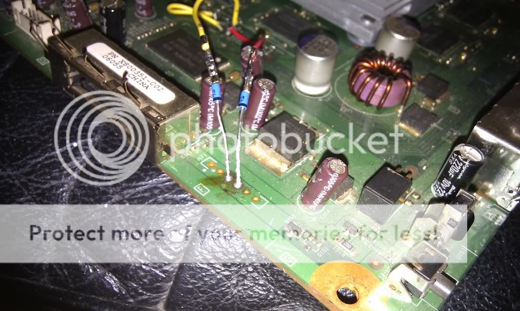

Does anyone have a diagram of where there J2D2.1 & J2D2.2 are? Which colour wire? And where are J1F1.3 & J1F1.4 on the board?
One last thing, are they diodes that are in the red/yellow wires. Are these safe to stay in?
Thanks!
Is this right?
umm, J1F1.3 and J1F1.4 are the holes in the top left of the pic (labelled 3 and 4 respectively).
If you soldered the J2D2 header already, it's fine. use a meter to see what hole goes to what wire. It shouldn't be that hard to work out.
Put one end of a probe on J2D2.1 and the other probe on the little solder point in front of the 2wire connector. You'll then be able to work it out.
It's a 50/50 either way. Try yellow to J1F1.3 and red to J1F1.4. If it does E79, then swap them over!

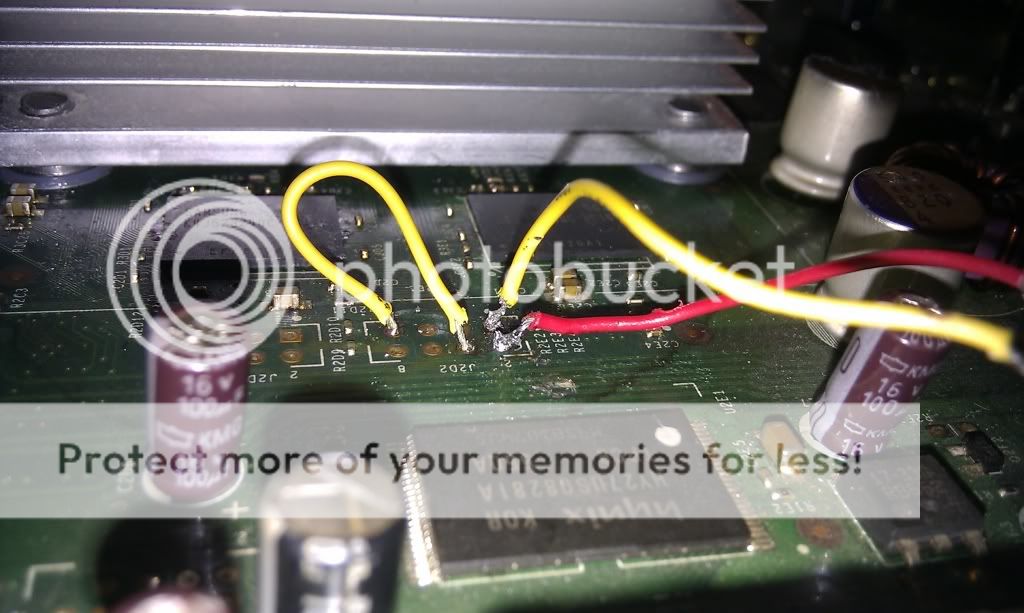

Just sussed it out now, the bottom pad goes to the top pin.
Soldered it all up, tested the pads where I soldered the board onto and I get good contact from the bottom of the board to the top.
Wires the 2 wires up and gave it a boot, no errors booted straight to blade dash perfect. Is there any possible way to test J1F1.3 and J1F1.4 for good connection?
I placed solder over the holes, kept the iron there and slid the diodes down. the diodes pulled the solder down with them and I just chopped them at the end. Pretty easy for my first time.
Hope everything's done right, ready for the respected member to loan me his Nand-X to Jtag it.

Cool - glad it's booting to blades still. I'm guessing you've not plugged the header into the socket on J2D2 at the moment? If you do, you should get E79.

Soldering looks bad without the pcb board, but the connection goes right through to the underside of the motherboard.

ok - you've stripped the QSBs away :)
Can you get your multimeter and switch it to 2kOhms (or nearest thing to this but more than this value). Get readings from the J2D2.1 and J2D2.2 when the Xbox is off and unplugged. Should be either 500Ohm or 1.5kOhm.
Your wiring for these points doesn't look too hot but check first and let me know.

I got around 460ohms for both of them. thanks!
