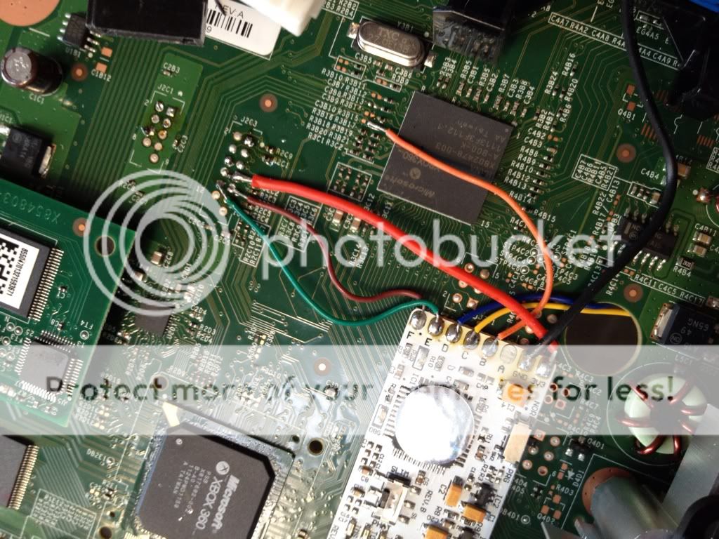

...then turns on and shuts down after 2 seconds, then turns on but turns off after 1 second, then it only beeps and doesn't turn on.
It seems as though the CPU is overheating or something along those lines, symptoms like that. Have you guys seen anything similar? Soldering is perfect because just 2 weeks ago I was playing games to test the system and it was perfect. I'm at a loss on this one.

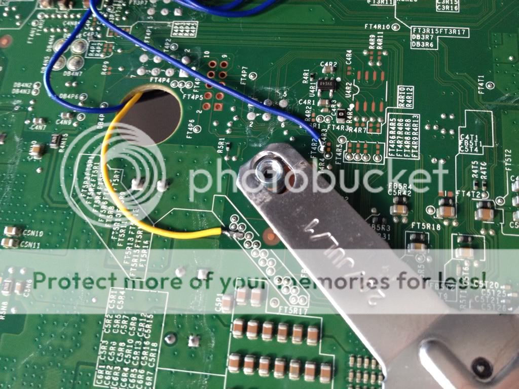

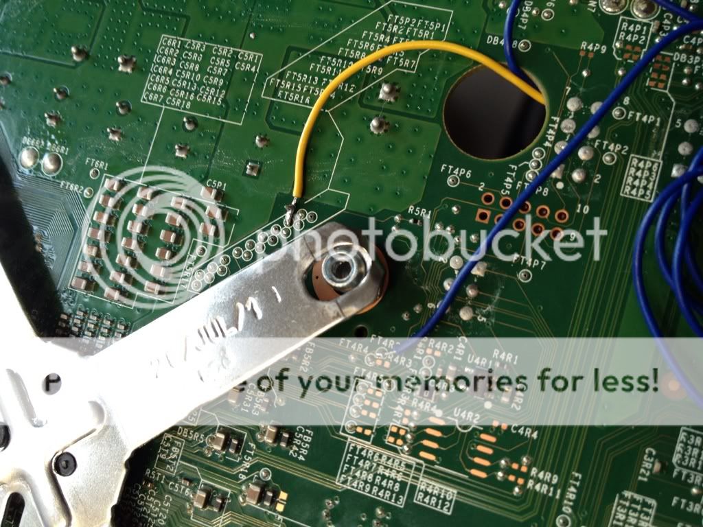

Ya dude console is down to the motherboard. l`ll have to post pictures in the morning :-(

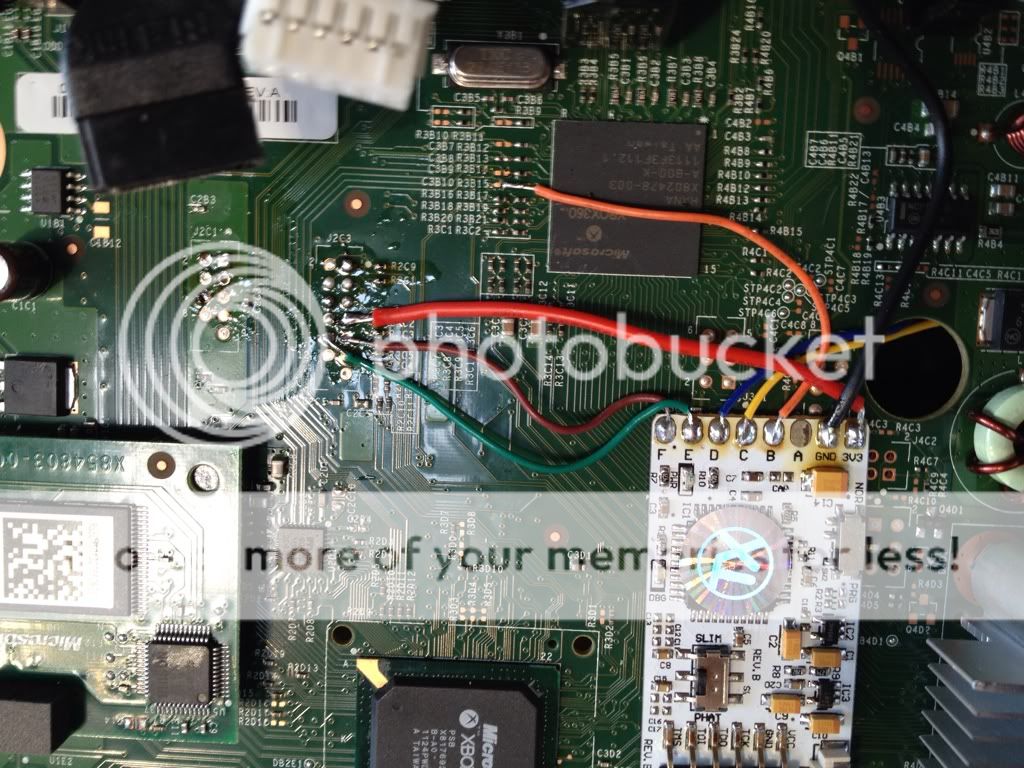

The console glitches fine, its just this shutting down issue. So the ECC, NAND image, DashLaunch are all ok.
---------- Post added at 07:59 ---------- Previous post was at 07:59 ----------
I use a lot of flux :p

I resoldered both STBY_Clk and the R15 (yellow, blue, burnt orange) and that seemed to fix it! I'll put the box back together and test further.
