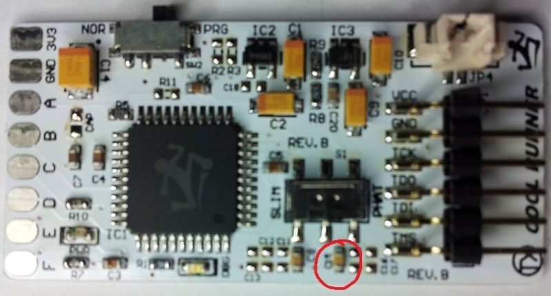

OK, I was able to retrieve key from xbox w/out drive using rgh 2.0 now I would like to use the CL on a slim. so my question is what can I use to replace the c15 cap I removed?
Link To Image
If you had to use rgh2.0 you are most likely on the latest dash. So why would you need to replace the cap if it is not needed to do the glitch? Maybe I missed something but I didn't notice anything, anywhere that said to replace the cap?

If someone can measure the c15 cap or knows the value it would be great. I had it saved, but I cannot find it at the moment to measure. PM it if you do not want to list it publically.
Found it but was not able to get a definitive answer on what value it is... apologies for that.

Capacitors cannot be measured with a regular multimeter. However, I think it must be of 1 uF or 3.3 uF.

Not trying to hijack, I was just wondering if anyone positively knows the cap, and if the cap for rev B is the same as rev A?

1.45nF measured with digitek dt-2844

Measured on coolrunner rev.B Considering the fact that this multimeter has accuracy of +-3% at 40nF, this cap must be 1nF(not 1,45nF)
