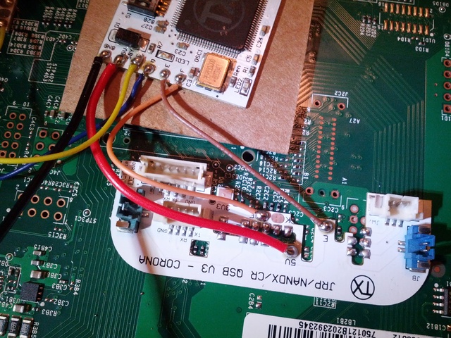

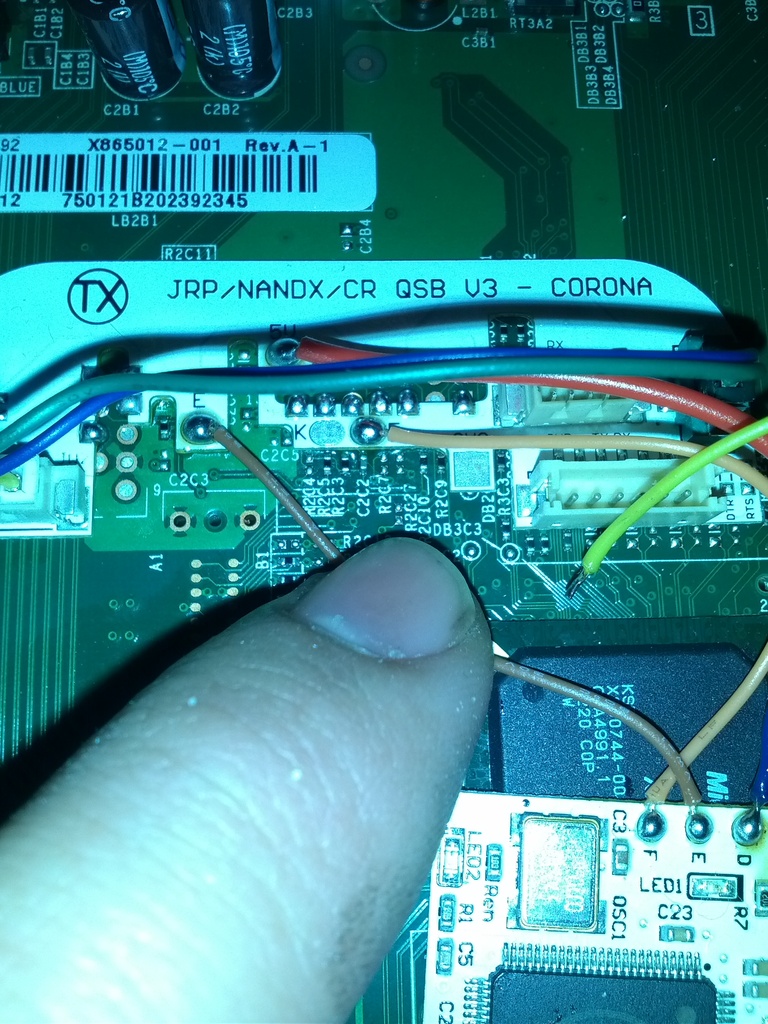

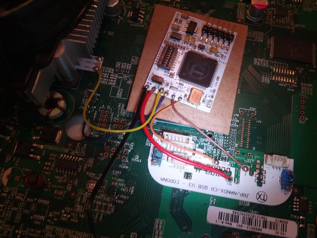

I could be wrong, but that looks like a v3 board to me.
I can't see any resistors in place at R2C6 and R2C7 next to the J2C3 header (without these pads bridged, the I2C bus won't work (E & F on the DGX)).

In your case, that is wrong.

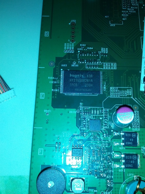

From what I can see, there is already a resistor on R2C10 which explains why you can read/write to the NAND just fine.
Bridge the R2C6 and R2C7 solder pads and watch what happens ;).

I uploaded these pics. You are right though they arent bridged, but I never bridged them cause it is a v1 according to tx website. I will bridge them right now.
pongopongo
Dec 18, 2012
52
cali
god damn blakey strikes again! I got my key! A million thanks. 14 hours on this sh*t. I even thought about bridging them before, but I thought it wasnt necessary for the v1. THANKS BLAKEY!

Like Bl4k3y said that looks like a V3 not a V1.
