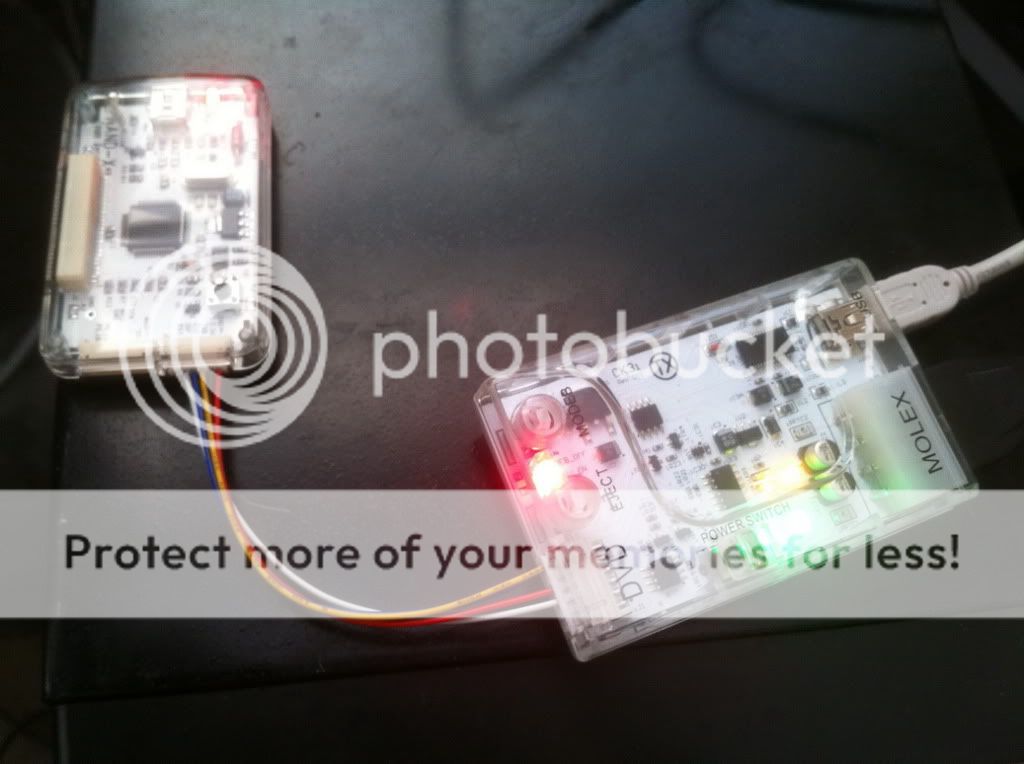

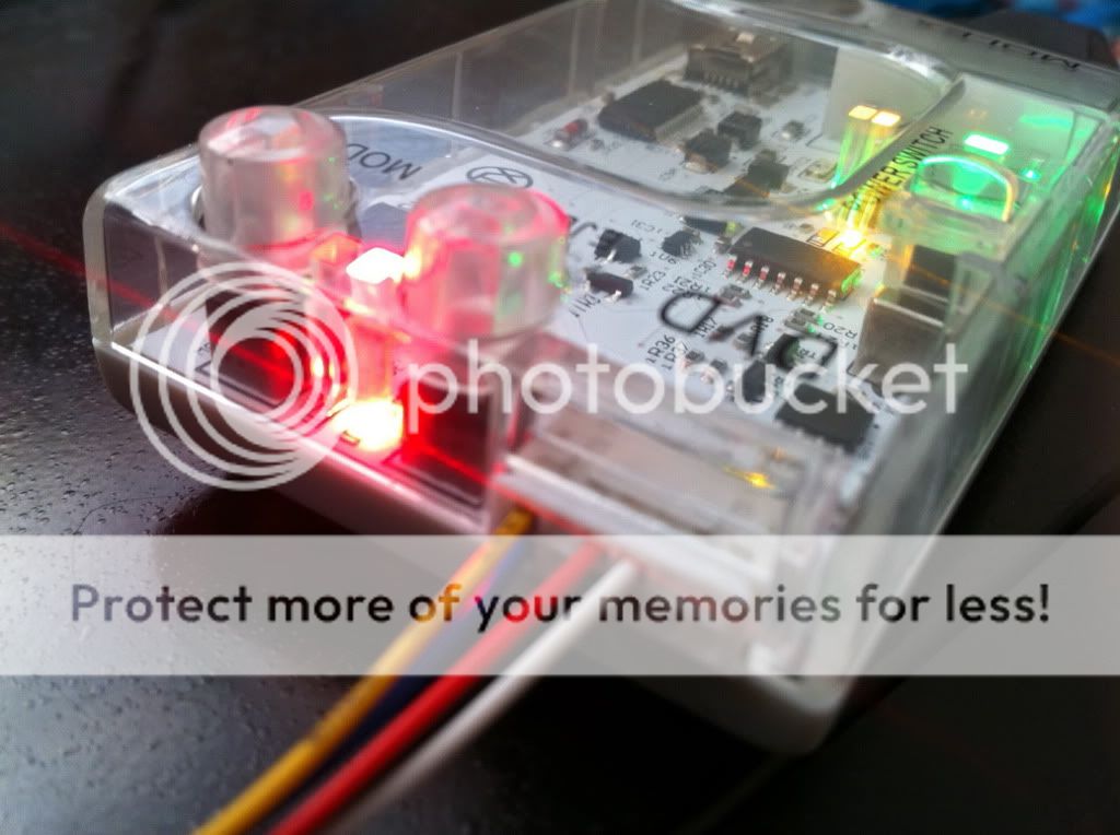

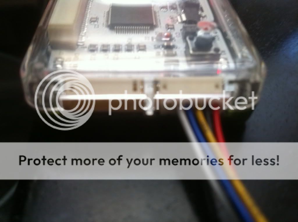

Hi, i've searched all over the forums and google and could not find anything that could help me resolve the Autobaud issue from flashmagic. Im trying to update my Nand-X from v2 (bought a few months ago and never used until now). I followed Ubers guide down to the details. Heres what i've already done.
-Checked the connections of the CK3i to NAnd-X Cable
-Checked if the pins are in the right slots of the cable
-Tried different flashmagic versions
-Tried different COM ports
-Tried different USB slots (and different USB cables)
-Tried different WINDOWS (64 and 32, XP, vista, 7)
-Tried different machines (PC, Laptop)
-Tried Oscillator from 12 to 14.745
-Tried all different Baud Rates
-Double checked the ARMv3.HEX file location
-Uninstalled and reinstalled CK3i drivers
-Powered off and on the Power switch on CK3i
-Pushed the reset button on the NAND-X prior to clicking start on flashmagic.
Im not sure what else i can do to make this work. Im attached my setup just in case anyone wanted to assist.

Don't think think it makes a difference but you could try changing to normal as your using the ck3i in mode_b at the moment.
Edit: Baud rate should be 9600 and why is there no options in step 2 there should be 2 check boxes

Forgot to mention that my Nand-x is not recognized when i plug it into my machine, no connections whatsoever, the red light comes on but no driver installations or prompts and none of that.
