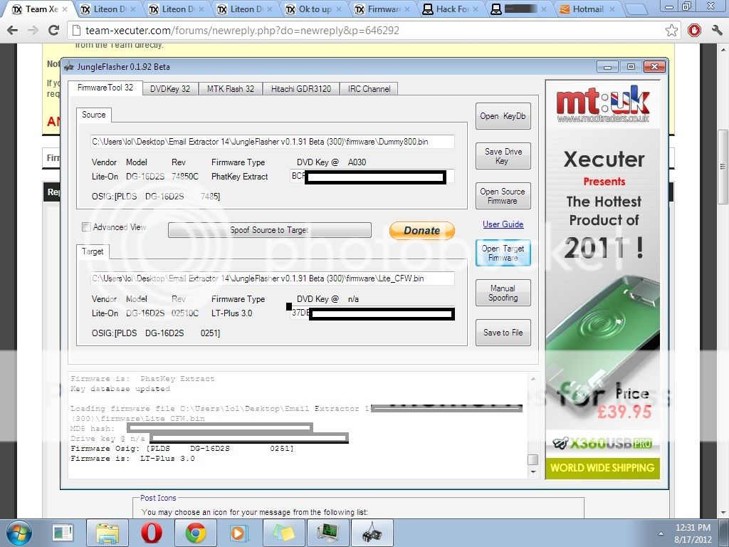

1 - load your old dummy as source
2 - load cfw or stock fw as target
3 - manually spoof source to target
4 - make sure keys match in source and target boxes
lite-on erase, once in vendor mode, write, outro
yes JF will warn you a couple times about erasing and keys, and are you sure

load your dummy.bin from the old drive to the source box in jungleflasher
assuming you have already extracted your key (dummy.bin) from the old drive?
I thought I explained it pretty clear even with a picture
and to answer your question the SOURCE being your dummy.bin which has your key and TARGET being the NEW FW (stock or custom) needs to be manually spoofed because your KEY in the DUMMY needs to be inserted into YOUR NEW FIRMWARE

Ok this help explain my issue better.
Also I saw your picture but when you said 4 - make sure keys match in source and target boxes.
I am sure you don't match them as i am flashing my old key.
Is this correct then lite on erase
Link To Image
you are making this way harder than it needs to be, i have already given you the instructions on what to do , read them again

I know it's not so what you are saying I don't need the new drive's key as source ?
talby71
Nov 24, 2010
3,463
Near Melbourne , Australia
the new drive's key needs to be replaced by the original drive's key or it wont work in your console...... original drive's key is source
after dash 13599 all phat liteon drives( including 74850) become 02510C
all that Frayed has said is correct, really couldn't make it any clearer
It's fine I got it to work I understood everything he said.
was just that I always though you had to use the source drive key as the source thanks for the help.
talby71
Nov 24, 2010
3,463
yeh that's correct , your original (old)drive is your source drive , the new drive is the target
glad you have it sorted
