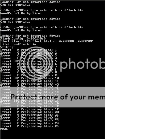

However, I had some errors when re-flashing the ECC.
It failed to program a few blocks. Hmm...

I could not program the NAND anymore.

I took the console out of the case and tried to flash the NAND again:
1. 1st time, I flashed it with "nandflash.bin" that I built before using 360multibuilder.
-->Write successfully without any error message. However console cannot boot up. CR green light blinks every 5s just fine. Front light of the console keeps blinking.
2. 2nd time, I flashed NAND with ECC image.
--> No change. Console cannot boot up.
Btw, my fuseset 07 has 3 'F's and fuseset 08 has no 'F'

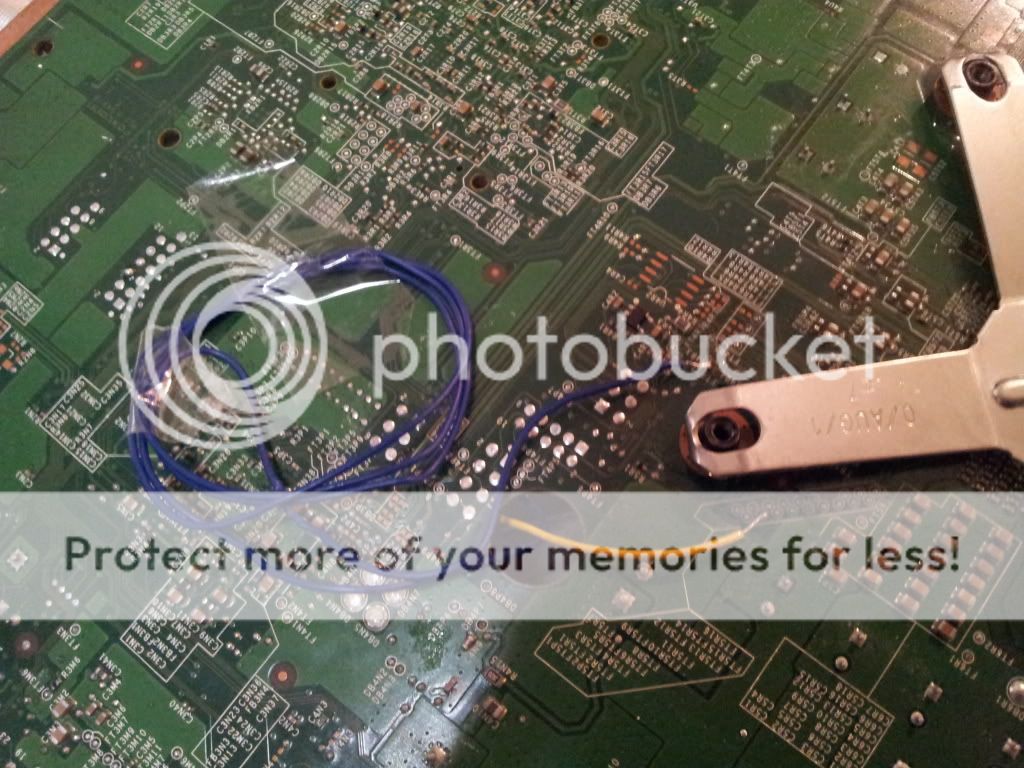

Dude! check your soldering! this much error is exceptional!
As I mentioned above, I managed to flash NAND successfully now. The problem is that console cannot boot up.
jackpalmer09
Jan 5, 2012
22
---------- Post added at 12:48 ---------- Previous post was at 12:47 ----------
Here are the pictures.
Appreciate all your help.
jackpalmer09
Jan 5, 2012
22
try wrapping up the CPU_RST wire under the xclamp and see if it will boot
Thank you so much.
I did what you said and I can boot to XELL now.

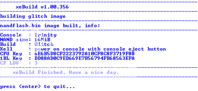

My Fuseset 07 on XELL has 3 'F's but my LDV value (after building nandflash.bin using 360multibuilder) is also 3. Is it supposed to be 4?
Shall I go head and rawflash again?

ldv should be what xell says so 3 is correct ..it should be the same
Woo hoo... I got it boot up to dash correctly now.
Thanks all so much, especially reefz3ro.
