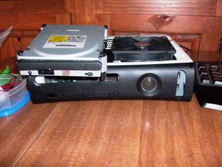

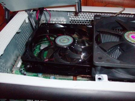

The reason I am water cooling my 360 is for practical reasons. I've modded my xbox a lot over the last year and I'm not interested in purchasing a new unit. The problems all started with a RROD over 12 months ago, and since then, air cooling has been struggling to keep her cool. It is now to the point where I need two 120mm fans placed directly on the CPU/GPU heat-sinks to avoid overheating. I do not get RRODs anymore, but it overheats and shuts off (two blinking red lights) For the record the x-clamp fix was completed with Arctic Silver 5. The 12v fan mod followed after that. Then I cut a hole in the side of the case and bolted a 120mm fan to the outside. Still overheated. Then I placed a 60mmx10mm fan on the arm of the GPU heat-sink. I took the case off completely. Now the DVD drive is off to the side, and taking its place is a CoolerMaster R4 120mm computer case fan on a 12v rail. And when that doesn't do it, I've got the behemoth Scythe 3000rpm Ultra Kaze 120x38mm. That moves 133cfm but sounds like an old vacuum. Now onto a nice quite, efficient water cooling set up. I hope you enjoy this 'journal' of sorts!

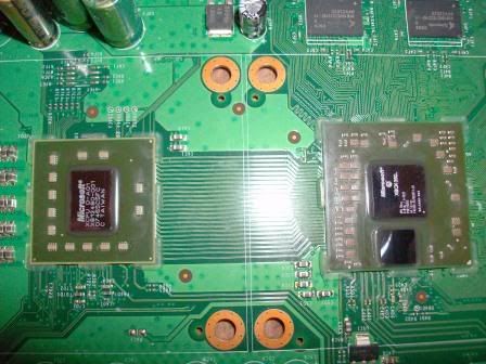

Day 1
Finally all the components are here! I'm going to start with taking apart the xbox and getting it ready to clean the cpu/gpu.
and after

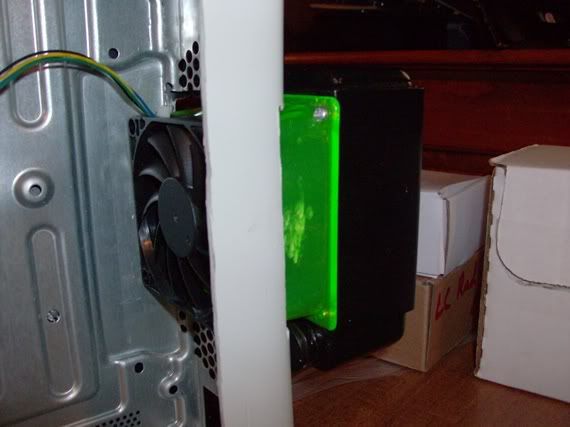

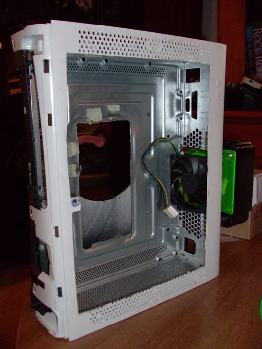

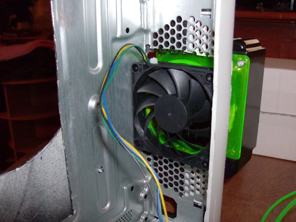

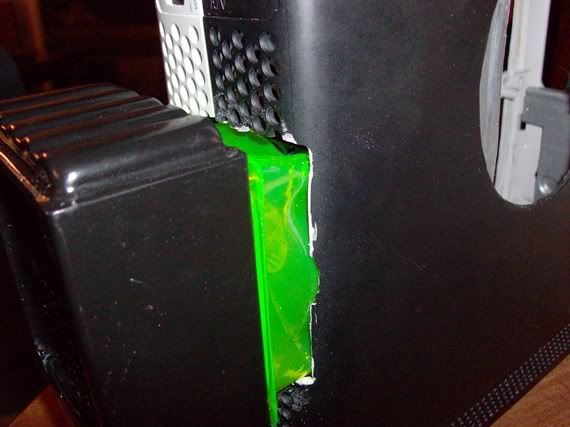

Now I will fit the fan, adapter, and radiator.
I used the dremel to cut the motherboard cage and case so the 70-80 adapter could fit.
I ran into a problem. It seems that the Thermaltake Tubing doesnt fit with the bitspower compression fittings. They are both 1/4" but the ID of the tubing is slightly smaller than the OD of the nozzle on the compression fitting.
So its back to Microcenter to exchange those for some 1/4" barbs. But that can wait till Day 2.

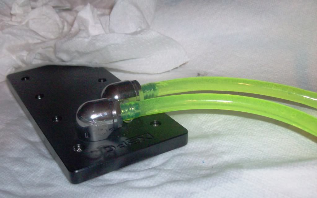

new fittings are here
going for a test run to check for leaks. i will provide more pictures when i start to fit things inside the case.

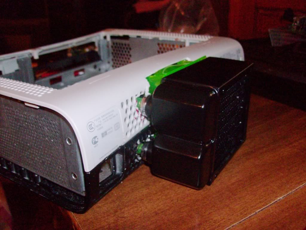

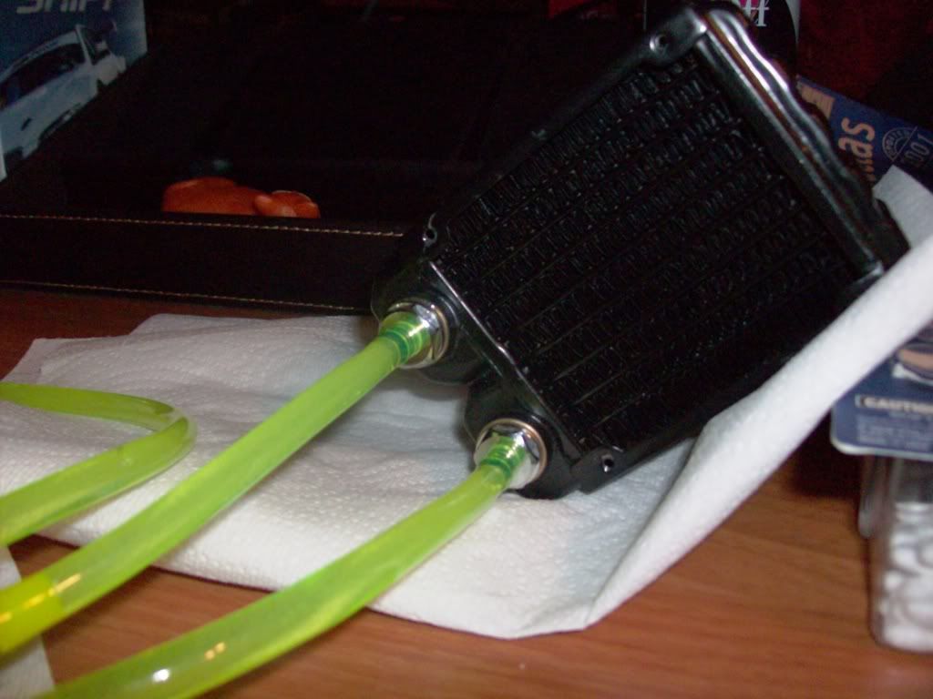

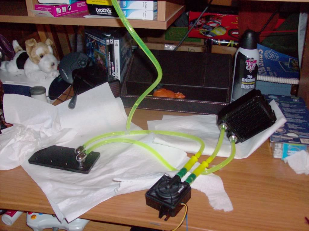

Day 2
It works! test run is a success with no leaks.

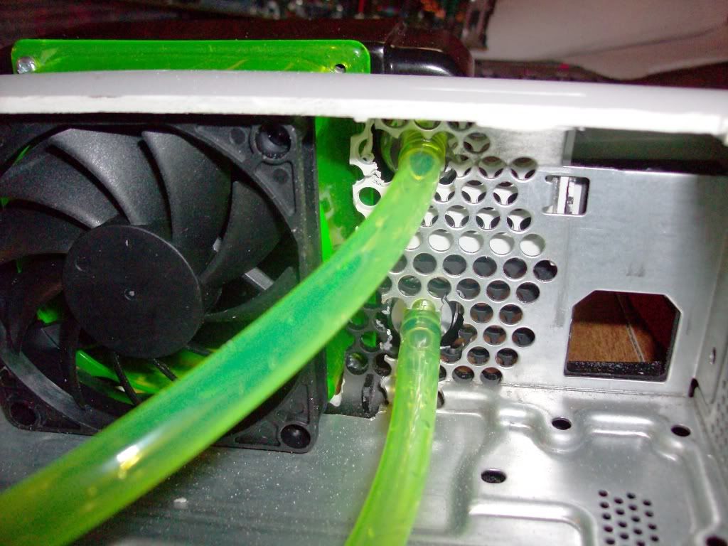

Mounted the radiator with barbs and passed some tubing through the case and cage.
Had to clamp the 3/8s reducer hardcore.

Day 3
2 videos showing the loop in action. I will be leaving the setup like this to see if it cools the cpu/gpu. if it does, then I will work on getting the loop inside the case.
Now onto wiring! :mad:
http://www.youtube.com/watch?v=mAZXxM17GUs
http://www.youtube.com/watch?v=TCd1YnUDPeU

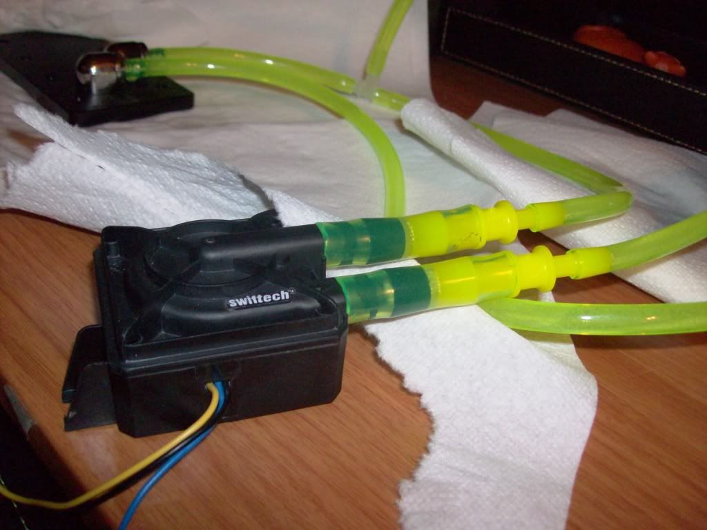

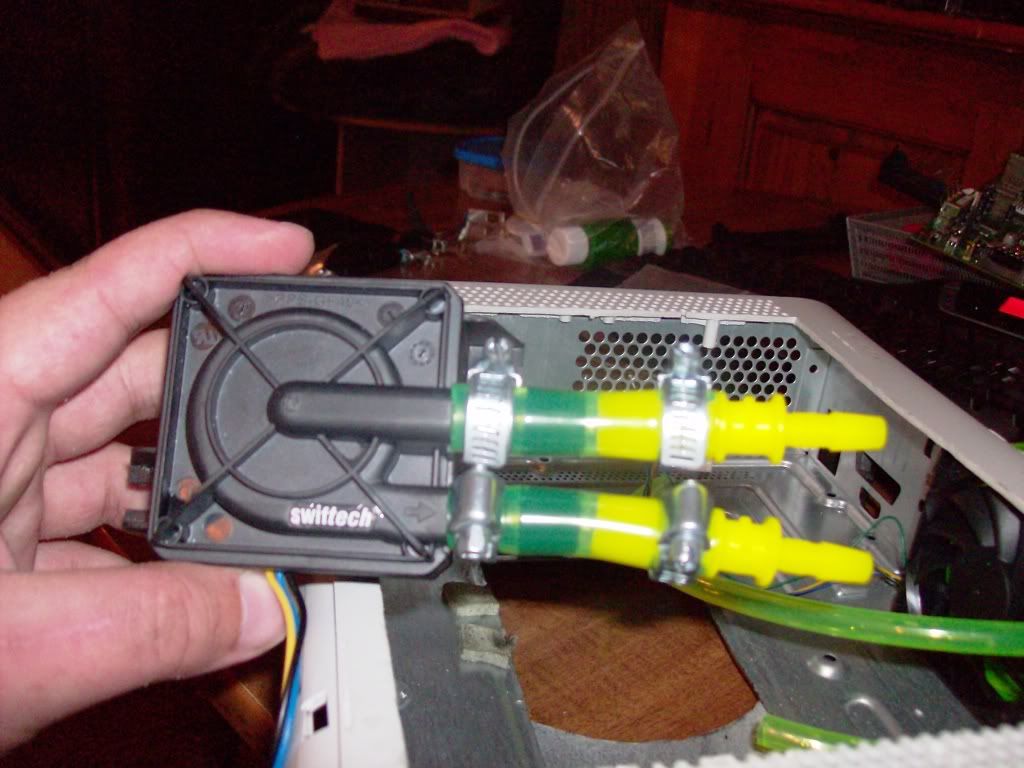

The difficulty has been about what I expected. There has not been any major set backs but a lot of fiddling. Space is a premium and i'm beginning to rethink some of my choices for the loop.
I originally wanted to go with 1/4" tubing because it would be easier to fit. Well, the Swiftech MCP350 is 3/8"s. I have to use this big ass reducers to get it to work. And those reducers are causing a problem with getting the pump lines to the radiator and the block. Options are this point are to use a hybrid of 3/8" tubing or to move the pump flush with the front of the xbox (behind the power button board) I have not begun wiring because the final placement of things is not set, and I am going to try and limit the wiring as much as possible.
Any thoughts would be greatly appreciated! Thanks for your interest!
