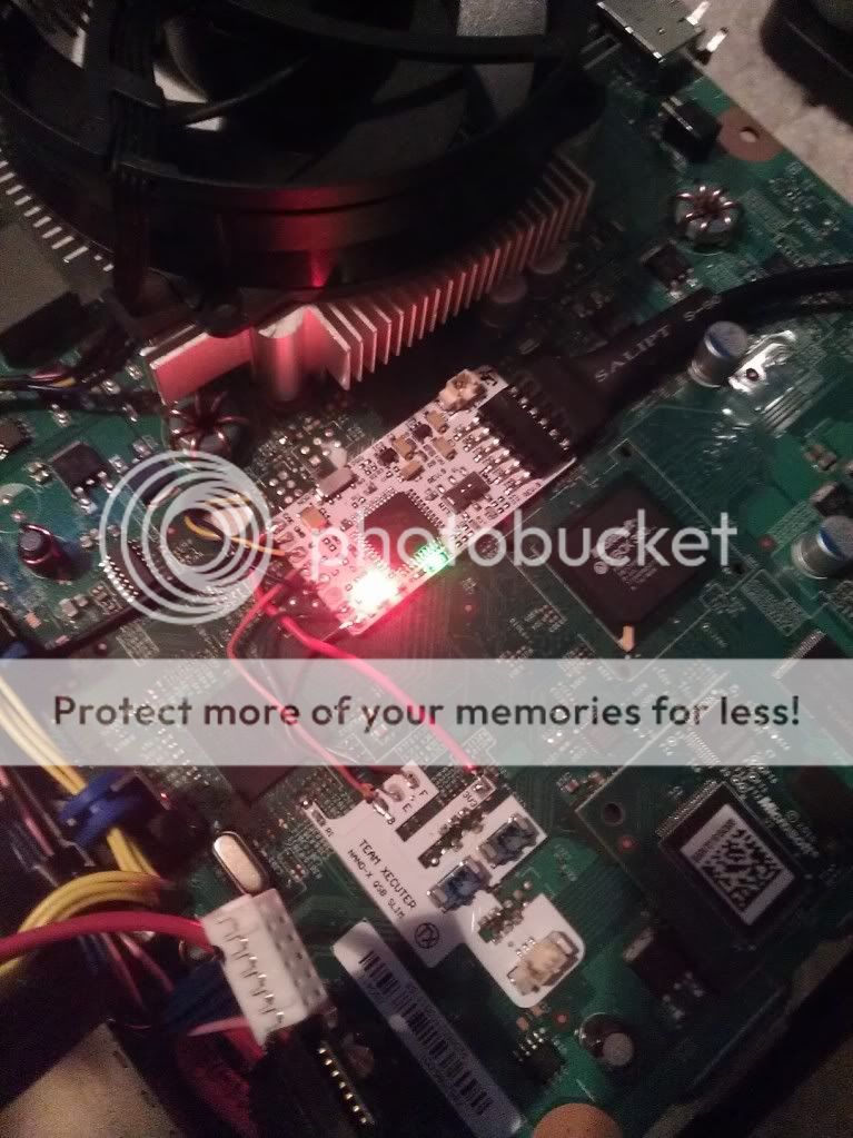

just got my coolrunner today and wired it up and tried to read the nand. This is the setup:
It won't detect in nand pro - it is plugged into my pc via LPT

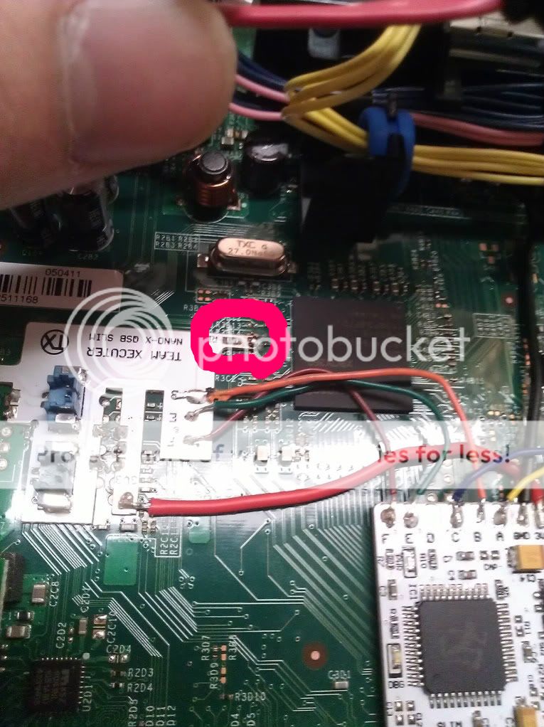

I am having trouble soldering the pad near the R1 Resistor, if it is not soldered, could this be the problem?:

i trim some of the wires a bit by 1 or 2 mm then solder back on.that 3v3 one i dont like that one,it looks like it hangin over onto a resistor.
can we have pics of the other side of the mobo.
the blue and green wires that would be.
yellow should be on c
blue should be on d
As XBOX4LIFE says,
WHY ARE YOU USING THE PHAT WIRING ??
Look at your points.
Point A is CPU_PLL_BYPASS for phat consoles.
CPU_RST should be going to point D.
Seriously, it's right there in the guide.

Why is your A on your coolrunner got nothing soldered to it? My A does, but my D doesn't have anything

I opened the pack that said Slim wiring on it..
---------- Post added at 17:05 ---------- Previous post was at 17:04 ----------
Why? Because you've followed the phat cabling for some unknown reason (and badly).
It's right there and colour coded too - tell me how you can mess it up?

Because if you can't follow a simple colour-coded diagram, you are in no position to even think about the next stages.

How could you possibly mix up an image of a phat motherboard with a slim? Exactly what diagram DID you follow? How did you manage to solder the E and F wires then?
