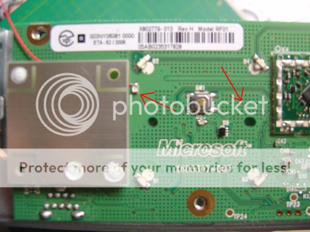

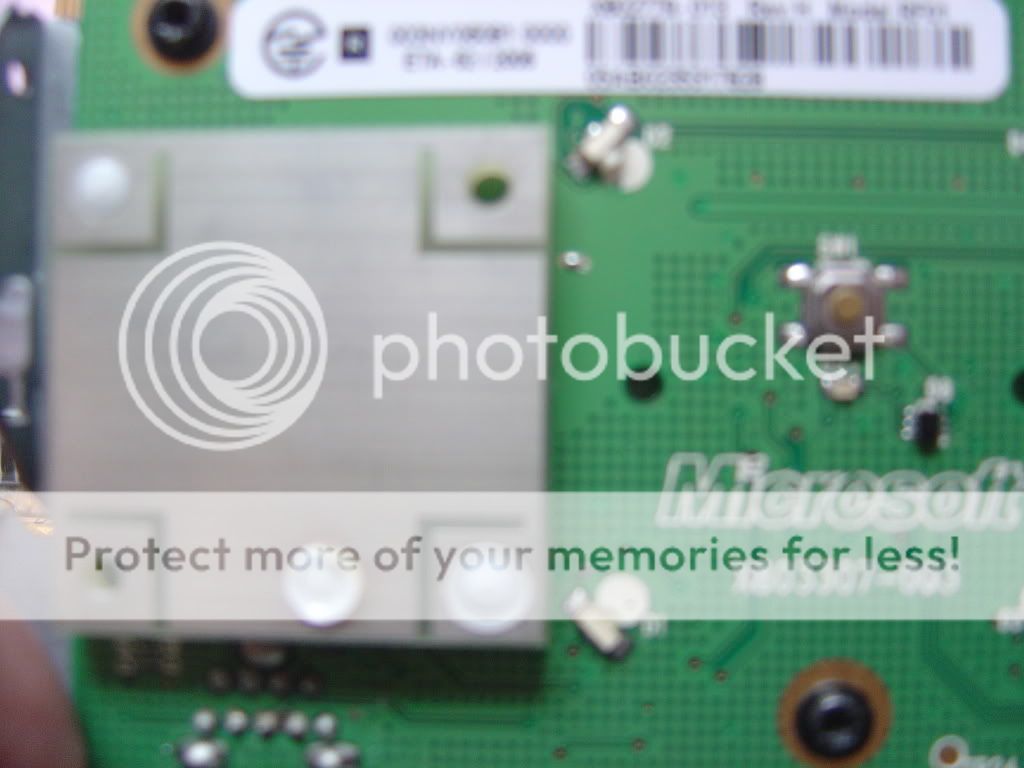

sorry for the poor pics but there good enuff for help first pic is just where i scratched and tinned ready Link To Image
second pic is led installed also if you look at the second arrow and of that grid is common ground so you can not far off put the leds where ever you want
Link To Image

yer sure no probs but do make clear any of the grid area around the rf should be ground and not just the spot i was pointing too

The only common ground I found near the player 4 ind. was a pin located directly under the led itself. I didn't realize that there were so many different rev. of the RF board. I went through a few I had in a box and counted at least 6 different versions. Anyways the pic below has the common ground I was talking about. You could add the - side of a extra led there and run the 1 wire from the CR to the + side. Will do more testing in a bit.
Link To Image
I soldered to TP24 pad for negative works fine on a added LED :)
