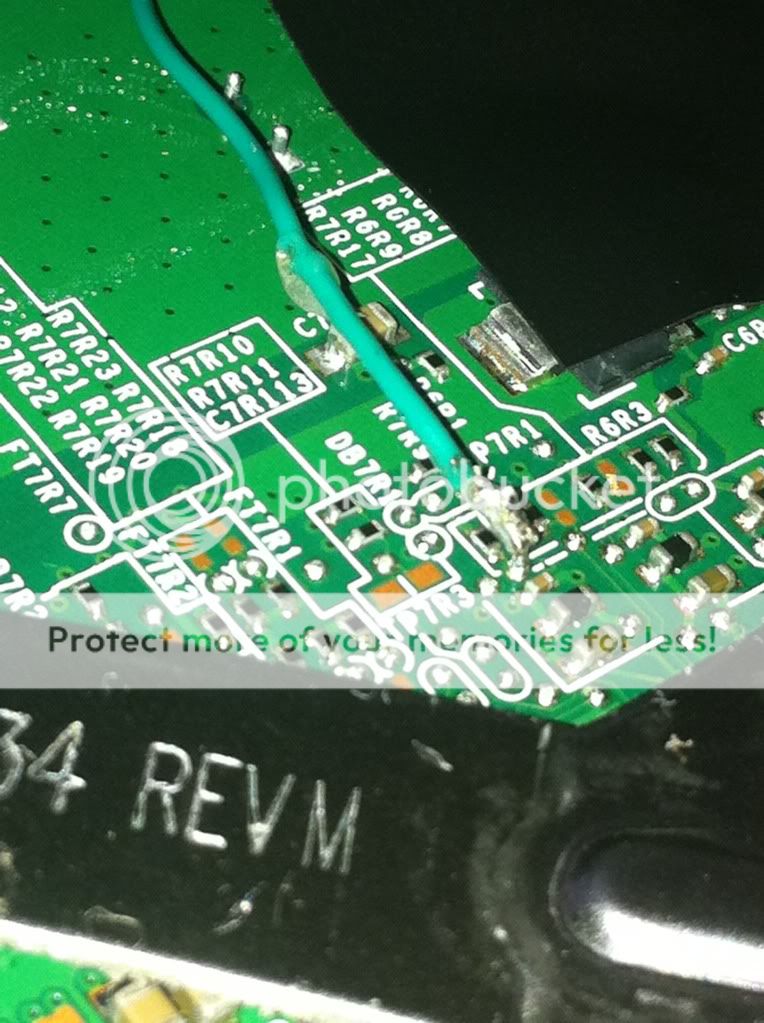

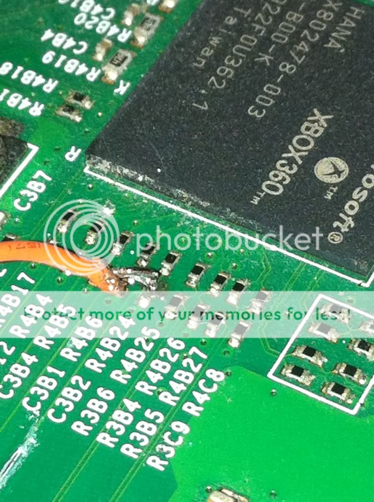

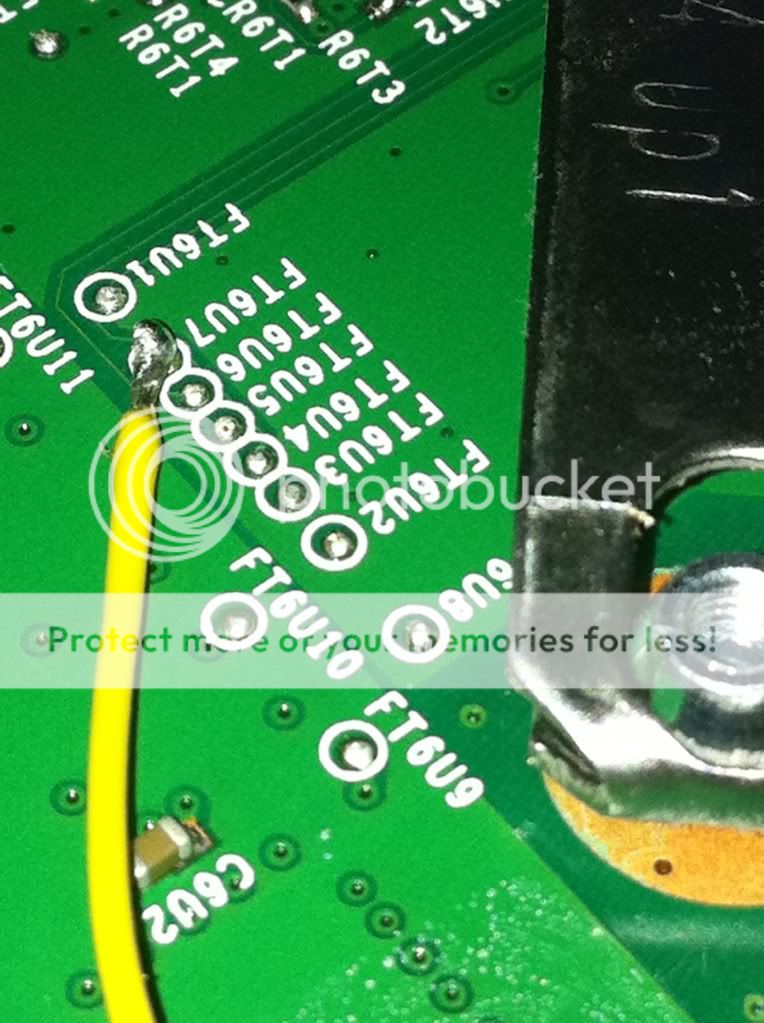

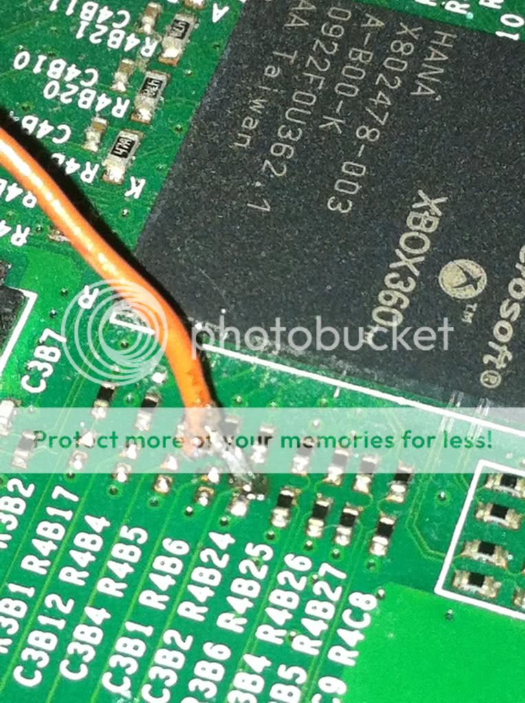

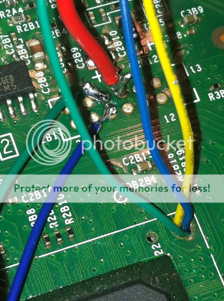

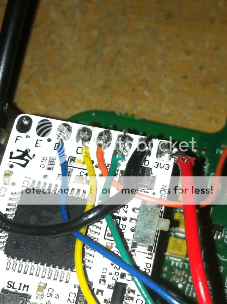

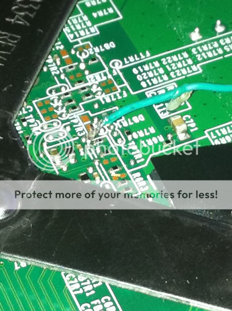

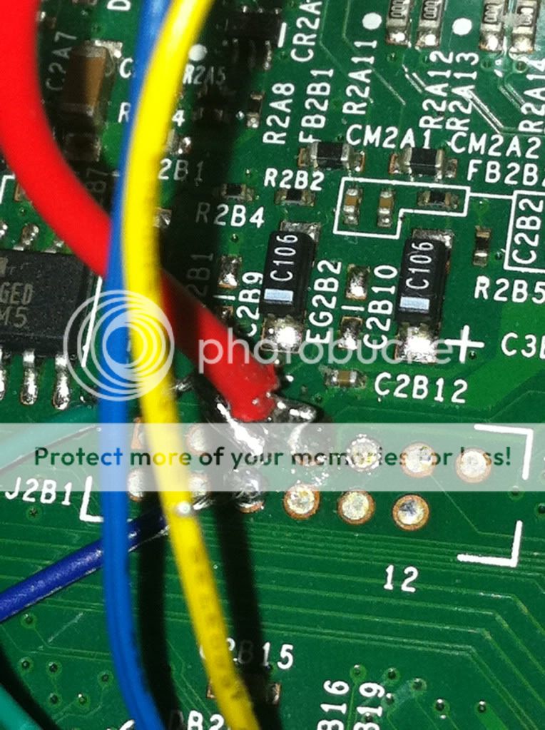

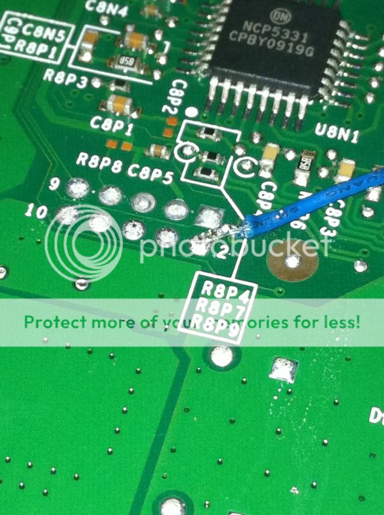

Here are some pics of install.
The orange wire may not look well attached from these pictures, but I used a multimeter to confirm that it is connected to where it needs to be and not to where it not needs to be. Also, the blue wire is not touching the other pad, it just may look like that from this angle.
