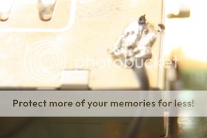

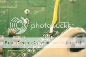

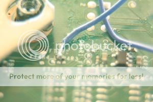

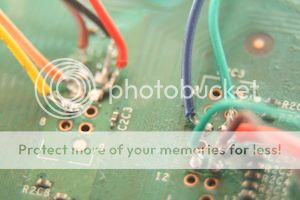

wrong post_out used.
d'oh!
the orange one? thats the alternative point. the original didn't work either
---------- Post added at 14:21 ---------- Previous post was at 14:21 ----------
my bad!!!! the yellow one!!! skool boy error
