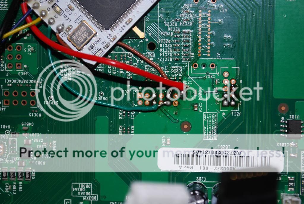

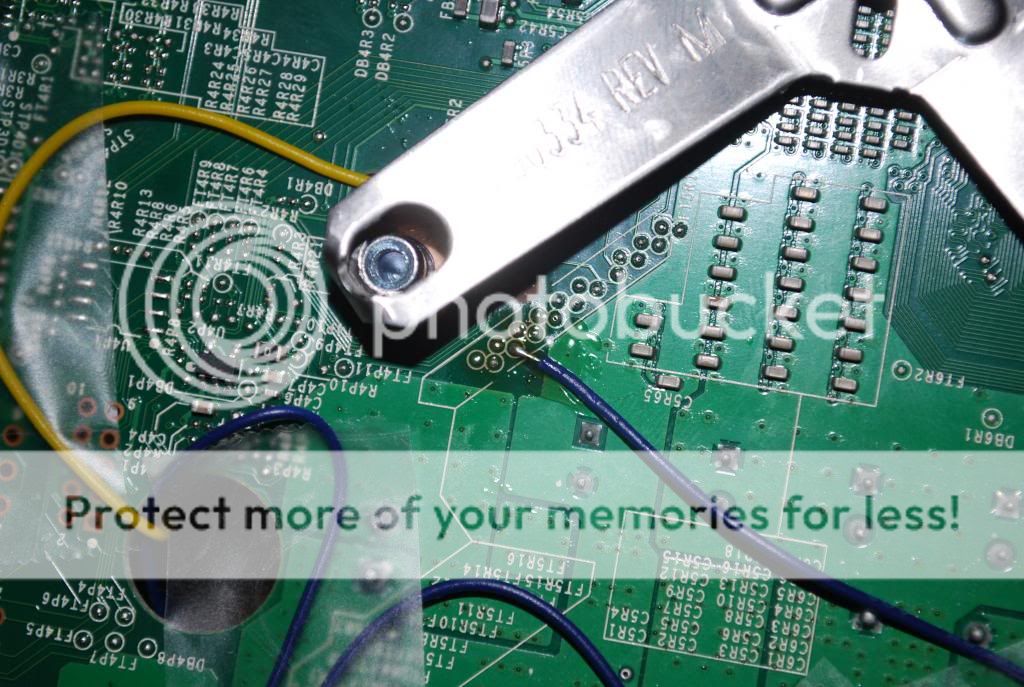

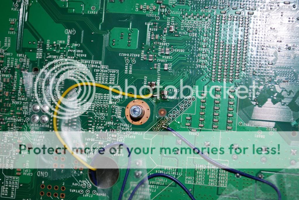

Hello all, i am having an issue with getting the DGX to work on a Corona V1. I dumped the nand and wrote the DGX.ecc and wired the DGX itself. When i boot the console, it glitches about 6-7 times and then seems to crash (fans make the noise it makes while glitching but continuously). I also tried Martin's Corona2.ecc and the console will either boot and after 6 glitches it will red dot or it will crash. I'm kinda confused now as ive been trying wire placements and alt points with no luck. Here are my logs and pictures as i read enough threads to what must be supplied.

try with longer or shorter post out cable ... the most times this is the reason for crashing and check the switch 8 in the dgx to be on and the rest off

Why are you using such a long POST_OUT? Where do we advise this?
You are absolutely correct! I saw that some other people had very good results so i decided to also try that, but it didn't work. I took some 28awg wire and cut it to about 11CM and it booted in about 8 glitches. Got the key via COMM and time to CR3 Lite it. Never will i not exactly follow the guide again :biggrin:
