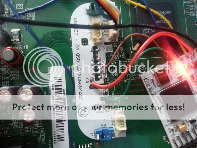

i have a corona v1 console that i cant get to boot xell. this is my first dgx install and i've used both dgx ecc's and still no luck. i've let it go for like 10 minutes at a time. i'm using corona qsb v3 with a coms cable as well. the dgx eccs also make my fans go to 100% is that normal? any ways, any help is appreciated. o yeah i also dont hear any "ticking" like i use to with other glitch consoles. this also has a demon install as well. install pics included below.

your post out looks like its in the wrong place on the board?? may just be the blured picture though.
looks that way to me as well,but as stated,could be the pic.

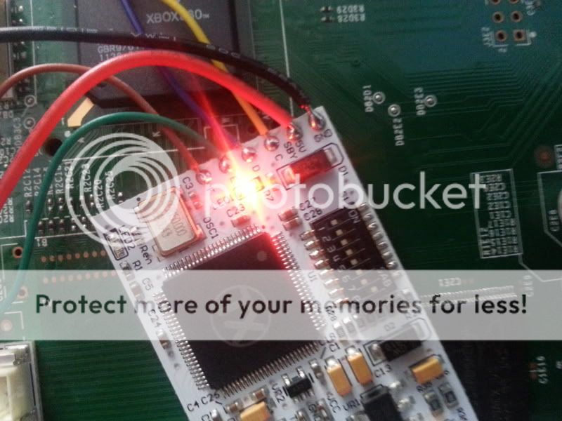

I just got a corona last night that I used my dgx on. I took martins advise that coronas work better the shorter the wires are. In the second image it looks like your blue cpu_rst wire is long on top. I put the dgx right by the hole where you pass the wires threw and cut yellow and Blue to exact length. Booted on second pulse.
Sent from my ADR6400L using Tapatalk 2
like a BOSS! i started shortening the wires last night and i finally just chopped it down to as short as possible and it booted first shot on the com monitor.
