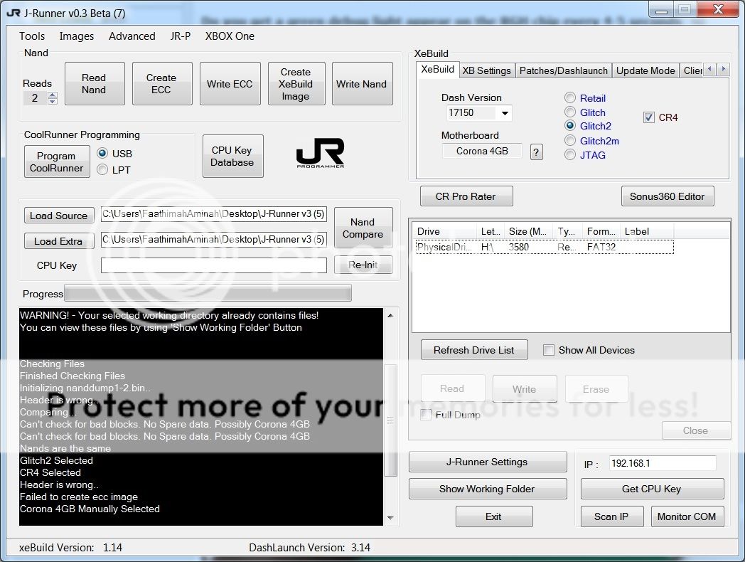

J-Runner v0.3 Beta (7) Started
Initializing nanddump1-2.bin..
Header is wrong..
Comparing...
Can't check for bad blocks. No Spare data. Possibly Corona 4GB
Nands are the same
Glitch2 Selected
CR4 Selected
Header is wrong..
Failed to create ecc image
Corona 4GB Manually Selected
Header is wrong..
Header is wrong..

Yes still have this nand :
Header is wrong..
Comparing...
Nands are the same
i have disconnected 5V from CR4 XL and try to write nand and Access to the path is denied.
and still wont turn ON the xbox
Wednesday, March 25, 2015 5:50:39 PM
Header is wrong..
Comparing...
Nands are the same
Writing to I:\ from C:\Users\FaathimahAminah\Desktop\J-Runner v3 (5) Core Pack\J-Runner v3 (5) Core Pack\output\nanddump1-2.bin
denied :(

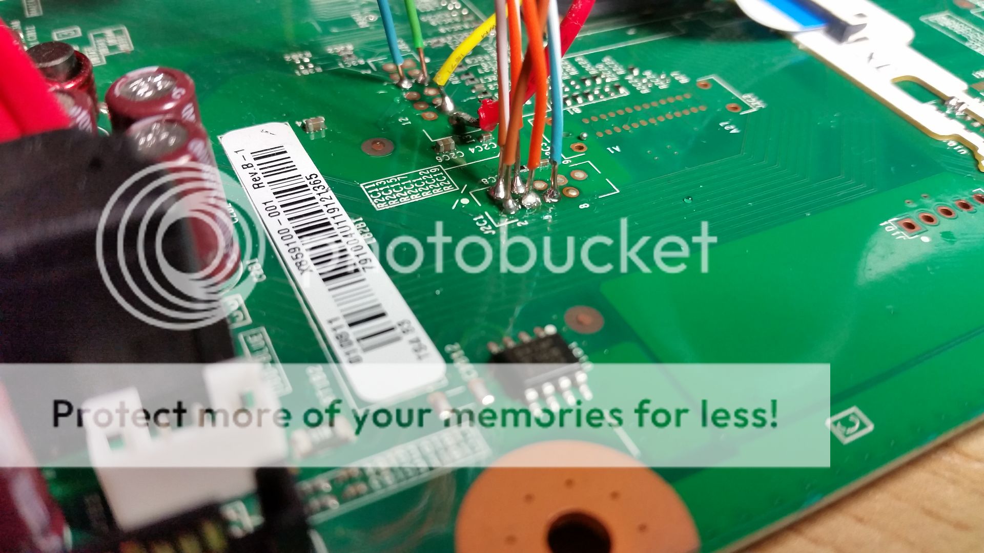

Start by removing those nand wires - in fact you can remove the CR4 as your goal now is to first restore power to the console by writing a valid nand. Those nand wires are not the same as the qsb as they have a completely different layout on the model you're attempting to mod.

HE Has already ben told that wires are not for this model If you have not removed the nand wires do so now !!!
NOW AT THIS POINT HE IS TRYING TO RECOVER FROM A BAD FLASH

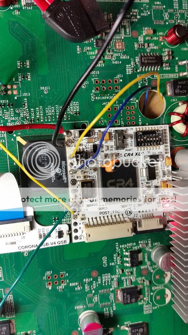

but i could write ecc :(, this is my installed cable cr4 xl, any something wrong ?

Please remove the Nand wires de-solder them Everyone keeps asking just remove them
