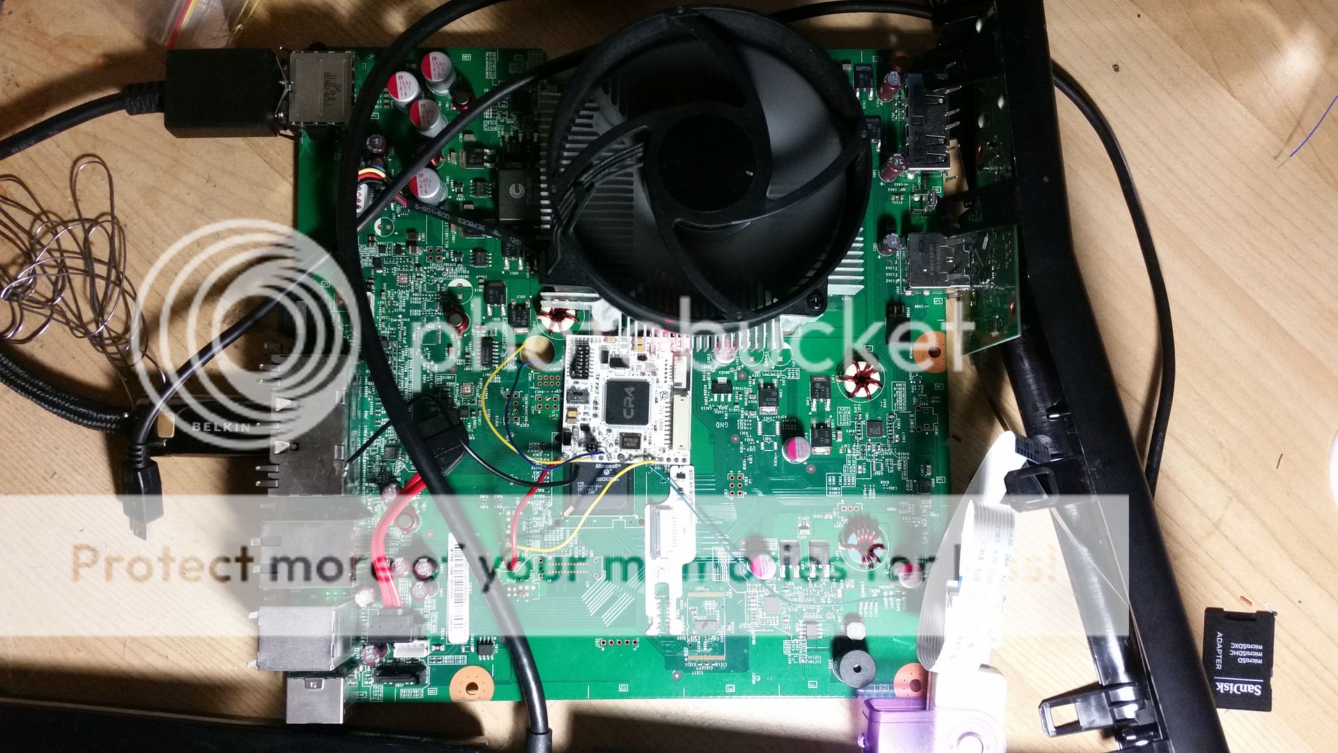

post a picture of your current work

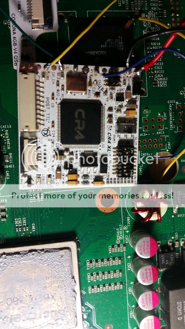

yes i did remove the 7 wire harness for JRprogrammer
and tried dips :
8.1 with 0ohms, 8.1 with 10ohms, 8.1 with 100ohms
8.2 with 0ohms, 8.2 with 10ohms, 8.2 with 100ohms
8.3 with 0ohms, 8.3 with 10ohms, 8.3 with 100ohms
still wont to get xell

The center Green light of the ROL sinc board is Green correct... the console is attempting to start when powering on correct if yes
Remove yellow post out wire from Cr-4 > Test ohms continuity yellow wire to ground

did you check to seeif you had full post under xcgpu heatsink?
yes, there is full post under xcgpu
The center Green light of the ROL sinc board is Green correct --> YES
the console is attempting to start when powering on correct if yes --> YES
Remove yellow post out wire from Cr-4 --> i have removed it now
Test ohms continuity yellow wire to ground --> not sure with this step ( i removed yellow post out wire from Cr-4 and then connect to ground ) -->still same thing
and also removed yellow post out wire from cr4 -->still same thing too
only red light came out

Hooking the post out yellow to ground--and powering on is a big no-no ..I hope you did not do damage
Do you have a multimeter now we really need to test the ohms post out short to ground
For now stick to settings post out 0 or 10-) have you tried dip 8-4 or 8-5
You can also write the dummy retail upflash bin back to the console then remove 5v from the chip
Start the console it should red ring after 20-25 seconds with secondary error 0022
Then if it does then write the ECC again and test for CR-4 green light
