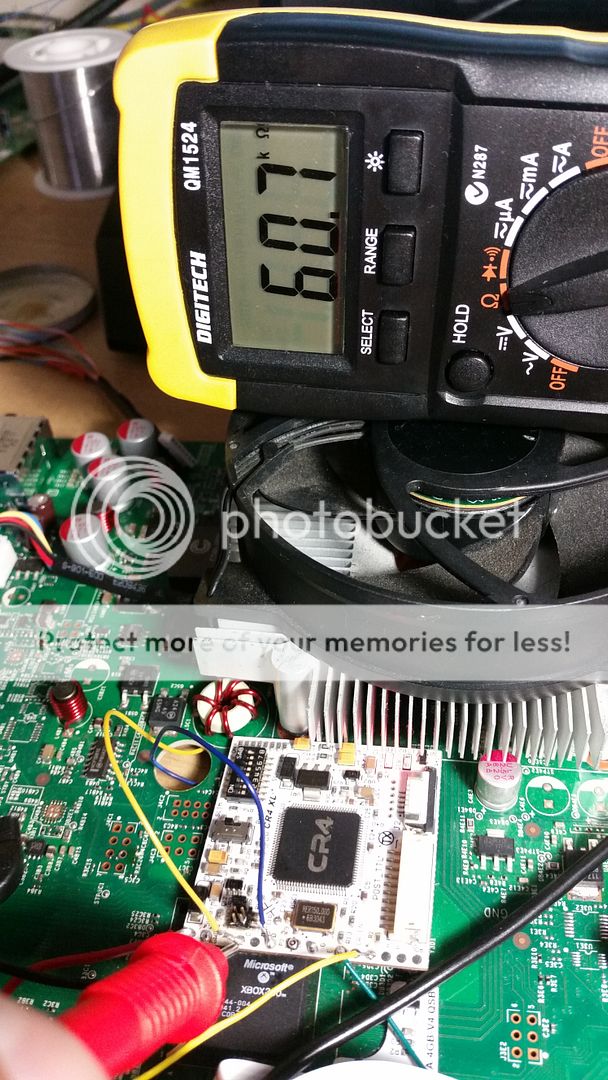

Not sure if your saying the ECC write failed or it just failed to boot but from what I see is it completed. You can't blame the chip for not writing (if that's what you are saying) and it to early to say it faulty just because Xell isn't booting. He still should verify that he has a true full post by measuring resistance between post1 and ground. It should measure ~60K.

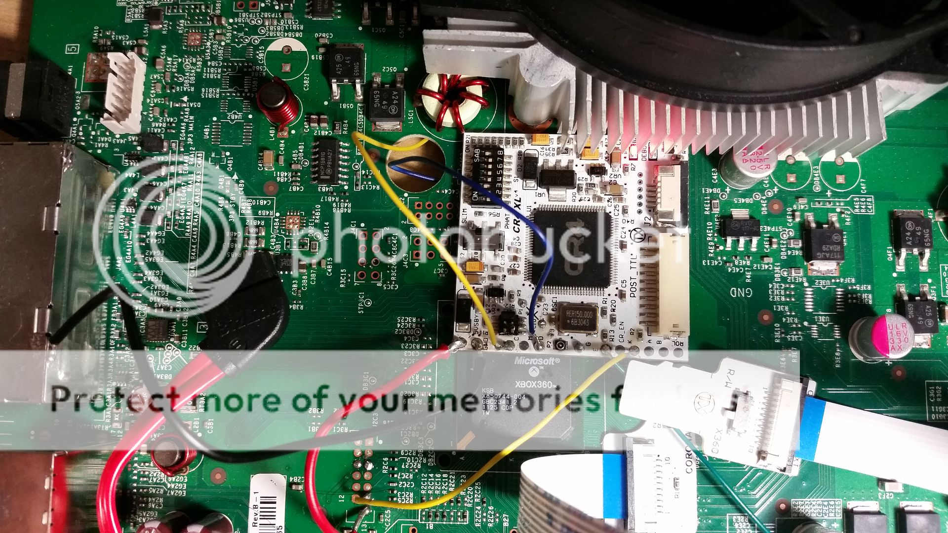

He included a picture of his board showing post out not removed ..I believe he is at work now anyway
so we will just see tomorrow
So he did. I missed that. I'm still hesitant on calling it a bad chip. There has to be a way to tell if it's programmed or not. I have a console in progress now. I'll probe around tomorrow and post my results of what I find.

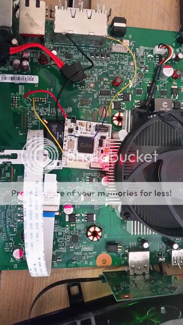

Hooking the post out yellow to ground--and powering on is a big no-no ..I hope you did not do damage
Do you have a multimeter now we really need to test the ohms post out short to ground

Why do you have the yellow wire soldered to the AV port?
i have changed everything and did measure between post1 and ground --> still wont to get xell
