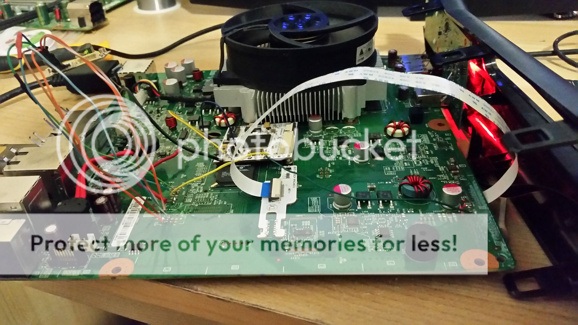

Corona V2 4GB QSB Nand Reader failed create ecc and power wont On
stucknvegas
Oct 25, 2012
656
Cypress CA. USA
With just your created dummy retail upflash bin written to the console no ECC should red dot after 30- seconds
Let me do a couple test for the Blue Cpu-rst wire
syaugi
Jan 5, 2015
57
Australia
lucky enough for me I had extras to try n they all worked except the 1 I tried so in short I don't think so on are end at least may have to return like im doing
I'm not sure they will accept to return or not, i lost the invoice for it
unfortunately i didn't get red dot from the console only green light, thanks stucknvegas for helping me :)

I am not convinced there is any problem with your CR-4 at this point
Your console should red dot with your created upflash bin
No red dot means you still have ECC written to the Machine or your console has a problem
Corona 4-G can get nand corruption ..It is very common..
Watch the writing status bar in Jrunner wile performing the write of the upflash
One of the symptoms is you can read the nand but not write to it
PM your Email address and I will send you one of my Nands to try
syaugi
Jan 5, 2015
57
Australia
pm sent.
yeah i dont think so my cr4 problem.
i'll post the log later

syaugi
Jan 5, 2015
57
Australia
just tried and came out red dot
this is my result :
-------- Wires installed --------
C = 0
M = 1.91
D = 1.9
G = 1.9
E = unstable and dificult to get results ( have changed the cable and still unstable)
K = 3.35
A = 0
B = 0
CR_EN = 3.29
Krafter
Apr 17, 2011
3,737
Indiana
this is my result :
C = 0
M = 1.91
D = 1.9
G = 1.9
K = 3.35
A = 0
B = 0
CR_EN = 3.29
Disconnect all the wires from the chip expect 5V and GND and take measurements and compare to my readings. Since your getting 3.3 on the CR_EN and voltage on D and M then I'd say the chip is programmed.
syaugi
Jan 5, 2015
57
Australia
so the light not blinking green
no, tried have played around with dips and still didn't get blinking green
this is new result :
C = 0
M = 1.91
D = 1.9
G = 1.9
E = 0
K = 0
A = 0
B = 0
CR_EN = 3.29
