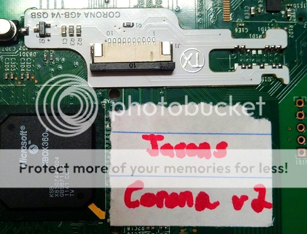

I'm working on a Corona v2 that the customer couldn't get to boot so I removed everything but the TX 4gb r/w pcb.
Here is a bigger pic of the 4gb kit so you can see soldering better but it's not related to my question. I just know martin like the pics to be sure we are using a official tx product.
