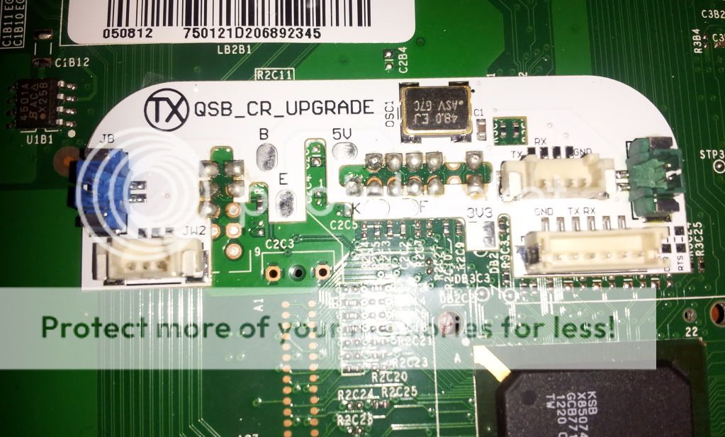

I never write a nand unless I have good dumps with no errors but with this Corona V3 (first attempt at a Corona) but I get errors on 2 blocks on all my dumps just wanting to make sure this is ok before moving on to writing the DGX ecc. I will post my Jrunner log and will take me another minute to post pictures since I have to post those from my phone any help would be greatly appriciated. I am going to using a Demon so really don't matter I guess that I can't get a clean dump from the QSB but would like to make sure everything works properly. Also I know my QSB has a crystal it was one I had already ordered and I will be using the CRv3 Lite so I know there is no need for the crystal on the QSB. Thank you for the help below are pics and J runner log the log is long because I tried dumping twice on 3 dumps. One shows alot of errors so i checked for cold solder joints and tried again.

No writing to it with bad blocks that would be stupid to do and yes it works nothing has been done besides reading the nand and qsb install. The 2nd set of dumps I did had remaps of bad blocks but I never rewrite a nand unless I have dumps with no errors and nands the same.
Well that's not strictly true - understanding bad blocks is key.
I'm more concerned about all the other errors in there.
If the console still works ok, delete ALL existing nand dumps you've made (there's no reason to keep them at the moment) restart J-Runner and dump twice again. Post the resulting log from J-Runner.
As I can now see your soldering, the problem may be to do with the fact your QSBs aren't soldered properly.
Add flux and retouch with an iron - you shouldn't see any of the copper collar on each point.

Alright I will add some more flux and solder clean up post new pic and j runner
yoohoomat
Dec 21, 2012
56
Murfreesboro, TN
Cleaned the points put new flux added solder and made sure no copper points are showing then cleaned up ran J Runner did not get as many errors as before but still the same errors that were remapped. Here is the log

You're not helping yourself at all.
Start again but this time actually do as I suggested.
Delete ALL existing dumps.
Restart J-Runner
Dump twice
Post the log

That was with the nands deleted out of j runner and starting over after I resoldered refluxed cleaned deleted the original nand dumps from output folder and did fresh read
yoohoomat
Dec 21, 2012
56
Murfreesboro, TN
Cause I did not do 2 dumps I did 3 but all 3 came out exact same exact 2 bad.blocks
So I ask you to dump twice and you do it three times.
Is there a problem with you doing as I advised or do you just like spewing log data out to a post? I'm trying to make sense of you're output and your inability to follow a simple task will most likely be your downfall.
So, let's start again.

Thanks - it was me being more pedantic than anything else, but it's easier to explain what's happening when I expect to see what I see:
Nands are the same
First off, NAND dumps match which is a good thing.
Bad Block ID @ 0x007C [Offset: 0x1FF800]
Bad Block ID @ 0x007D [Offset: 0x203A00]
Confirming your NAND has two bad blocks.
Bad Block ID 007C Found @ 0x03FF [Offset: 0x107BE00]
Bad Block ID 007D Found @ 0x03FE [Offset: 0x1077C00]
J-Runner has found the content of these blocks was already remapped by the Console (as they should be for correct NAND operation).
Block ID 03FF [Offset: 0x107BE00] remapped to Block ID 007C [Offset: 0x1FF800]
Block ID 03FE [Offset: 0x1077C00] remapped to Block ID 007D [Offset: 0x203A00]
J-Runner remaps them back for you to continue using the NAND image without an issue.
So you're fine to carry on with these dumps. The bad block is nowhere near XeLL so your ECC creation and write shouldn't be affected. When it's time to build the new image, J-Runner / Xebuild will remap these two blocks for you ready for writing.
Reactions: yoohoomat

Thank you martin c that's what I thought to and was 99.9% sure but better to ask and get someone else's brain to confirm. I figured since it was not in my first 50 blocks it was OK seeing how it remapped them and cell only uses those first 50 blocks thanks for confirming.
As I said, the remapping is a temporary thing to ensure your NANDs are valid for J-Runner operations. It's not 'fixing' anything at this stage. A bad block is a bad block.
yoohoomat
Dec 21, 2012
56
Murfreesboro, TN
I don't plan on writing anything to the original nand but use the demon to run everything and this weekend when I have a chance install the demon and get a dump from it also see if I still get bad blocks but anyways use it to run my xell keep my original band on the Xbox untouched.
For demon operation, ensure you choose 'noremap' in xebuild advanced options then write to the DemoN with Advanced/Write Fusion. Erase the DemoN NAND first though.
yoohoomat
Dec 21, 2012
56
Murfreesboro, TN
Alright I will I am sure you or someone has written a tutorial on here I will locate if its out there (which I am sure there is) thanks for all your help martin will post again if I have anymore questions or concerns to anything I can not locate on the site.
