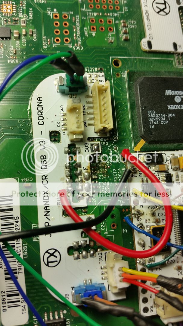

i have bridged r2c10

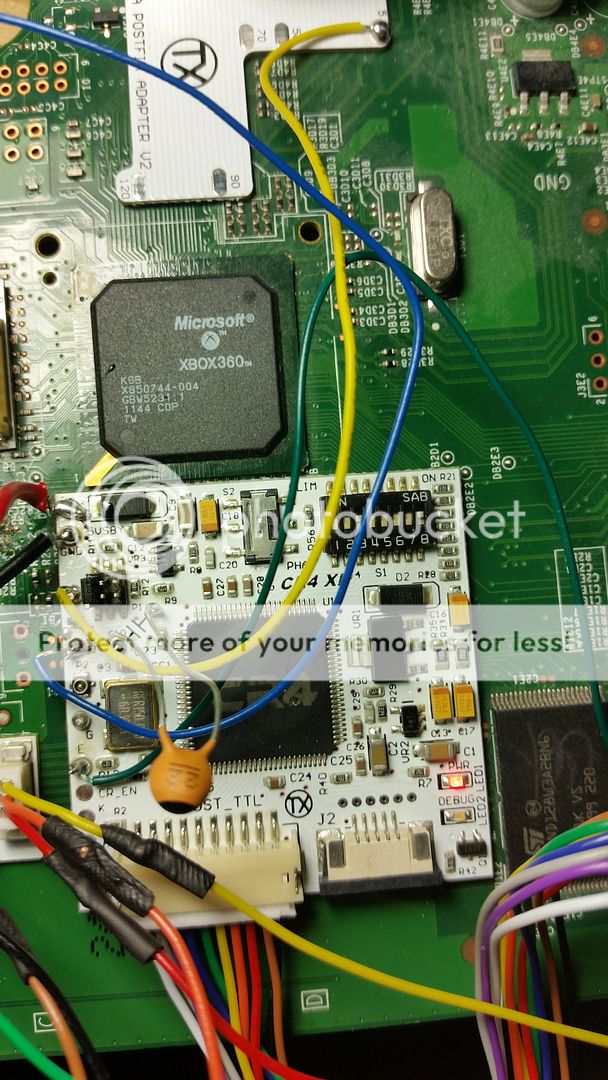

Green debug light needs to be flashing. This can be down to bad connection/soldering on post out or CPU_rst.check these points. There is a bit of exposed wire on CPU_rst point. Cut it down and resolder.

he didnt even select cr4 op check the cr4 box and trinity mb / glitch2 create ecc write ecc/ that doesnt fix it x=check postfix adapter make sure it seated correctly/ solder on the cr4 is bad i would cut them wire down and add flux and redo it:biggrin:

OP, could you remove the yellow wire and measure the resistance between the "5" pad on your post fix and GND?
i did select cr4 box with glitch2, it was successfully ecc created and wrote ecc,
i checked post fix adapter, there was yellow pin broken and does not touch to the cpu ( might be this problem ? )
and also i have done resolder on the cr4 wire with all cables
i tried to measure with multimeter, was not connected
