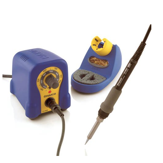

Can anyone suggest a good soldering station for about 100.00?
I second frayed's recommendation for the Hakko soldering station, but if you are cash strapped, google yihua 936 and look for it from a large hobby store. Less than $20 when it stock. Find some old electronics board and practice soldering on that, use good flux, keep the tip tinned and once your comfortable go at the QSB again. Don't try and remove it, just clean it up. Or go with a reputable modder here to have it done for you.

I'd even suggest that you practice on something simple such as soldering wires together and learning to "flow" solder before soldering on junk boards.
