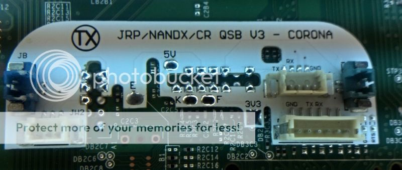

It Has The Following Nand Chip In The IMG Below:
Description of problem:
I'm trying to read this 360e corona v5 nand but it always gives me this massage:
Version: 10
Flash Config: 0xFFFFFFFF
IoTimedOut
IoTimedOut:No more bytes!
FFFFFFFF
I think my soldering is fine, but open to suggestions.
I bridged the following points:
R2C4, R2C6, R2C7, R2C10 Had A Resistor
Was the console working before you started: Yes & It Still Boots Retail Dash
CORONA v5 Voltages As Shown In Martins Guide:
1. 2.421v
2. 3.320v
3. 2.425v
4. 3.330v -- 43.5 Ohm
5. 3.072v
6. 000.1v -- 57k Ohm

I haven't installed anything to the motherboard but the v3 QSB because dad tod me to read the nand before I installed anything else, do you want to see the jr prog v2 connected to the v3 qsb?

UPDATE: JRUNNER can read the nand on our other consoles fine so it's not the jr prog v2 or the nand cable..
I just wanted to make sure you had connected the J-R P v2 correctly to the QSB and have tested continuity between each NAND point (from my guide) back to the programmer.
I'll get u you a pic here in a few..
I tested continuity with the cable plugged in from the socket legs on jr prog to the bottom of the motherboard to see if i had continuity thru the cable and v3 qsb and all was good. I have since removed the v3 qdb to try a direct wire install..

The only points which throw any suspicion for me were 1 and 3, as these should be around 1v. 2v4 is quite high.
I wasn't going to give up on this console so I removed the v3 QSB and did a direct wire install and now it sees the console as a Corona & reads the nand perfect. I'll try a diff v3 QSB and see if it works.

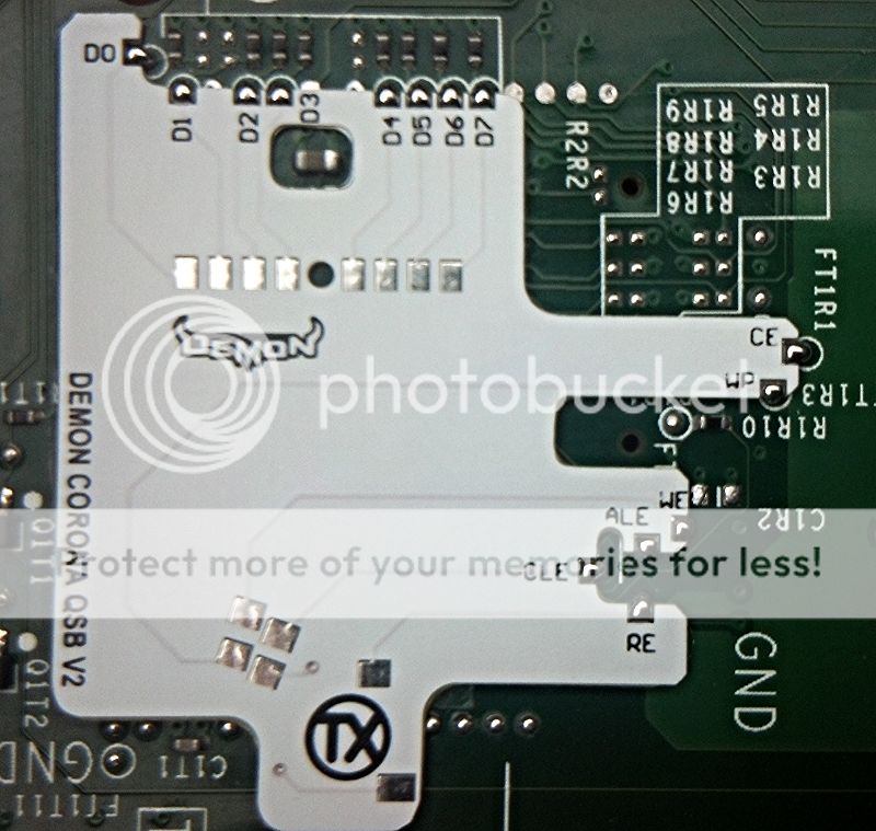

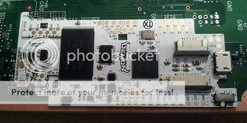

I have slim proto 2 & demon installed already and booting on both nands. All i have to do now is fine tune the boot time and install a phat sonus.
here is a couple pics of the demon & i'll post more later. if you have any suggestions on soldering please post because it will help me out in the future. Dad taught me by making me solder on a dead 360 motherboard and after i got the hang of it he let me install some xecuter mod chip in an original xbox.

your soldering looks good to me, im very excited to see your final installation when you finish it

pro soldering. Good work young man

i'll get all pics taken today, i couldn't find original slim proto v2 wires so I made due with 2 colors of 22awg solid copper wire.

here is a couple more pics for you guys to look at and leave suggestions. Keep in mind this is my first rgh/jtag that I've ever done.. Thanks again to Martin for his help along the way & Dad for teaching me how to solder, feels so much better actually doing it myself instead of using a console that my dad did.
In the pic above I couldn't find the proto v2 wires so i just used the 22awg wire that was laying around.
Will post more pics of led mods later today after I finish & the proto v2 settings used for the best boot speed.
If you check the forum Surprise Dad!!! :) Got my first one done, lol..

Very nice work, i have seen alot of "pros" that didnt perform half as good! And good soldering :)
