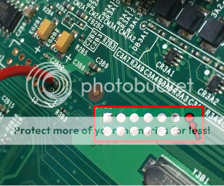

If you use the RGH 2 Method im pretty sure you do not need to use any form of the aud_clamp fix and for the power of the CR4 Goes here...
