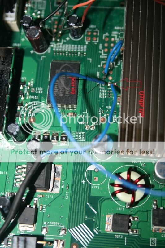

heres some soldering pics

Raptor, from your pictures you seem to be using the standard JTAG points for HDMI board but my xell files are made to use the alternative points (AUDIO_CLAMP & OPEN_TRAY signals). If you used my xell with the setup showing in your pictures this could be a possible reason why it did not work.
