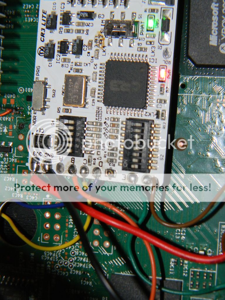

I've spent almost all day on this one xbox. dashboard version 14719 cb version 9230. First I use a coolrunner rev A it would never boot in to xell. So I tried a coolrunner rev C.. Still wouldn't boot into xell.... So I tried a cr3 lite and a DemoN. original nand will boot on retail side and DemoN side(disable coorunner for it to boot). Write the ECC to DemoN nand using j-runner app. still not booting.
CR3 Lite Jumper Settings
LK1 - Short (Disable Crystal)
LK2 - Short (Disable 10 Ohm on CPU_RST)
LK3 - Open (C15 Disable)
LK4 - All Open
I let the j-runner pick which timing file the coolrunner is using.
I not going to clean of the board until i get it working.
Took this picture as it was trying to glitch

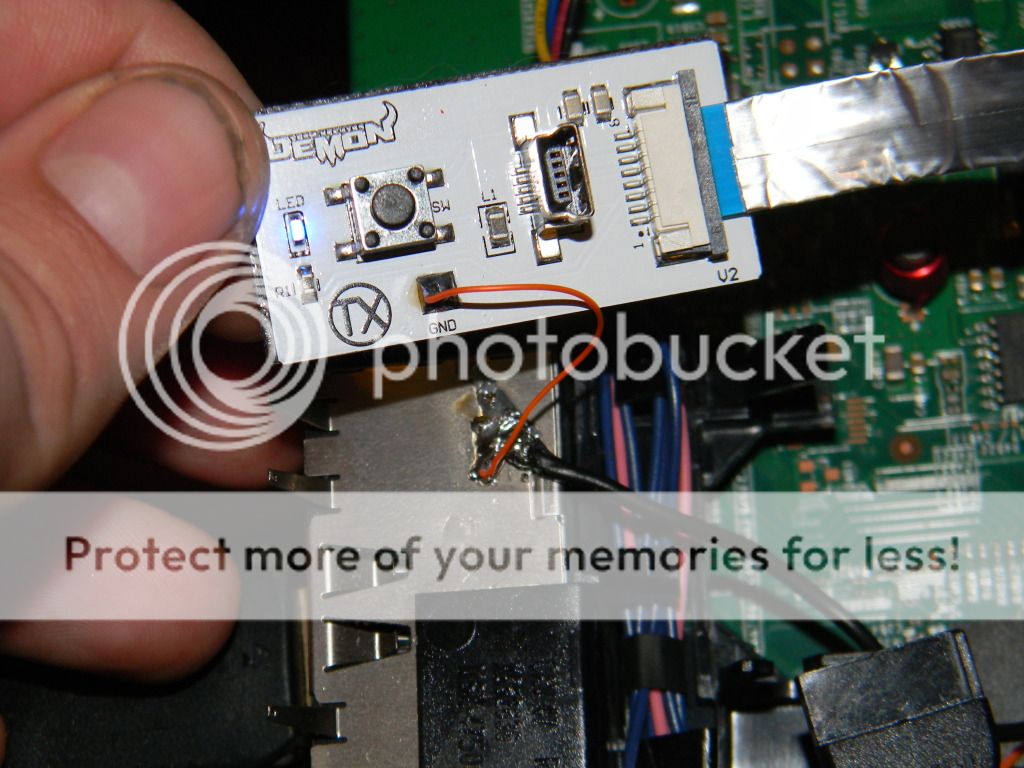

you should use a thicker Ground wire for the external usb nand reader, for a better nand read, that orange wire is to thin, that might help you out for getting bad blocks

I used a 360nandflasher to get the image before I wired up the demon. You right though I do need bigger ground but that not causing the problem right now.
You shouldn't need to remap bad blocks for the DemoN, so writing the ECC directly to it should be enough.
Set DIPs on the CR3 so 1 and 5 are on.

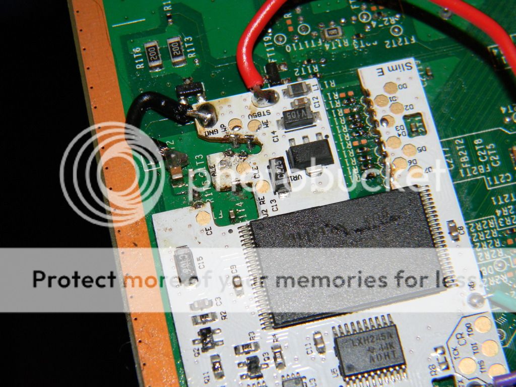

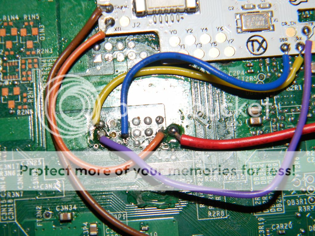

A better image of your CPU_RST repair is required too.

I knew you would of seen the CPU_RST repair if no one else did. If u must have a pic , i'll post one. The xbox will boot just fine on the retail nand on and on the demon nand with the original nand back up. I had the DIPS on 1 and 5. In that pic I was messing around with the DIPS trying to get it to boot.
