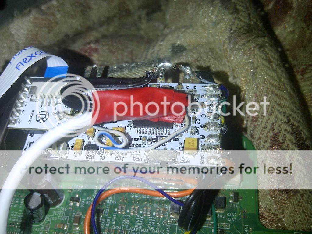

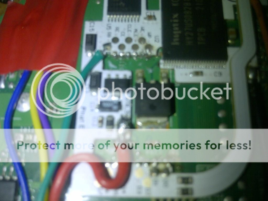

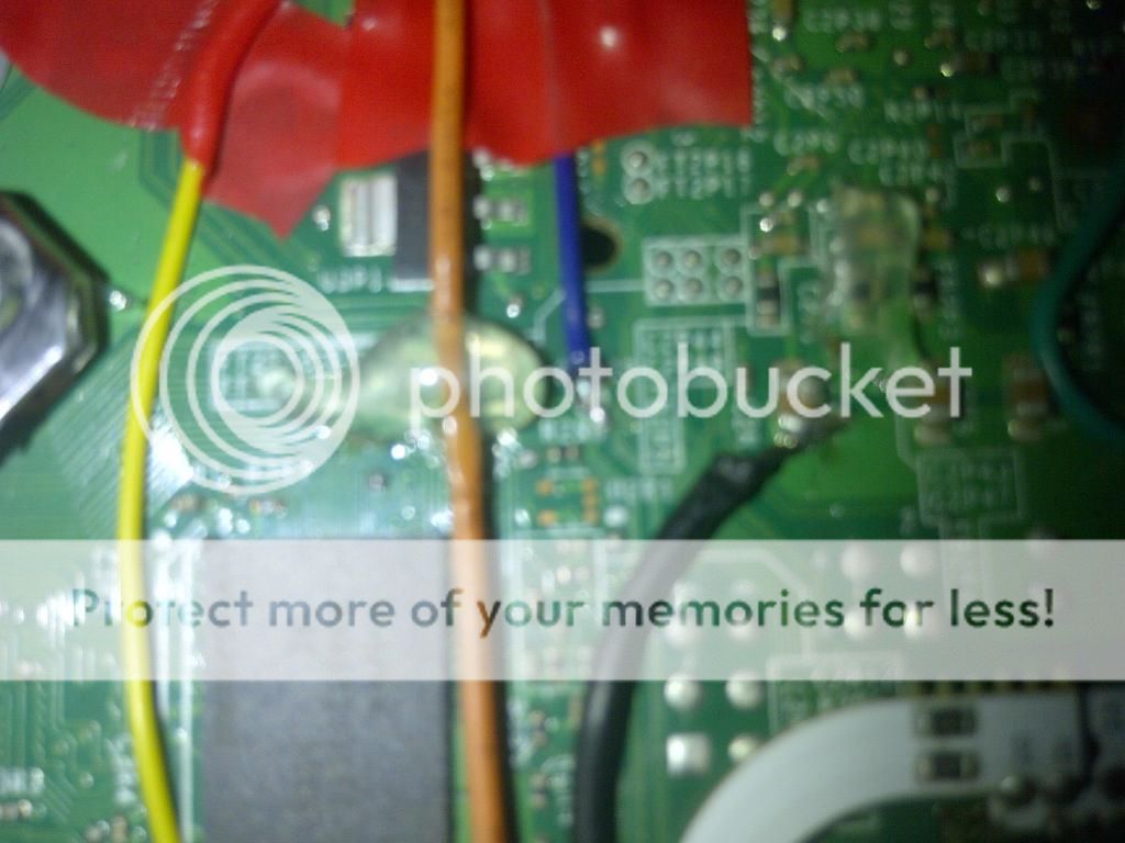

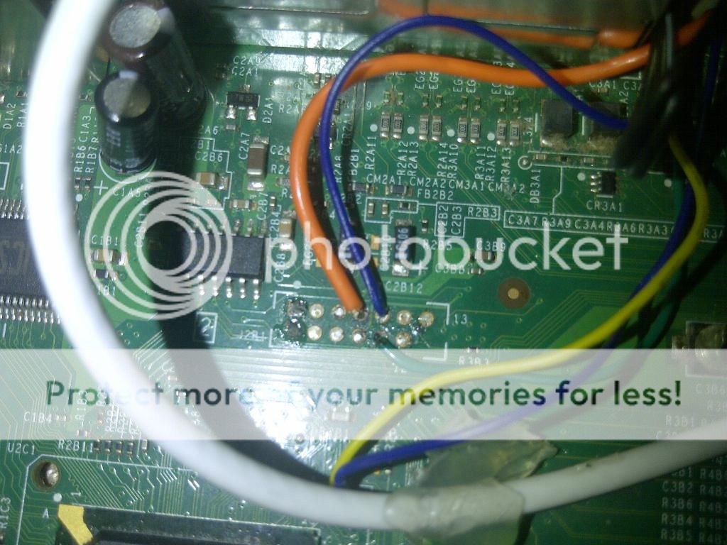

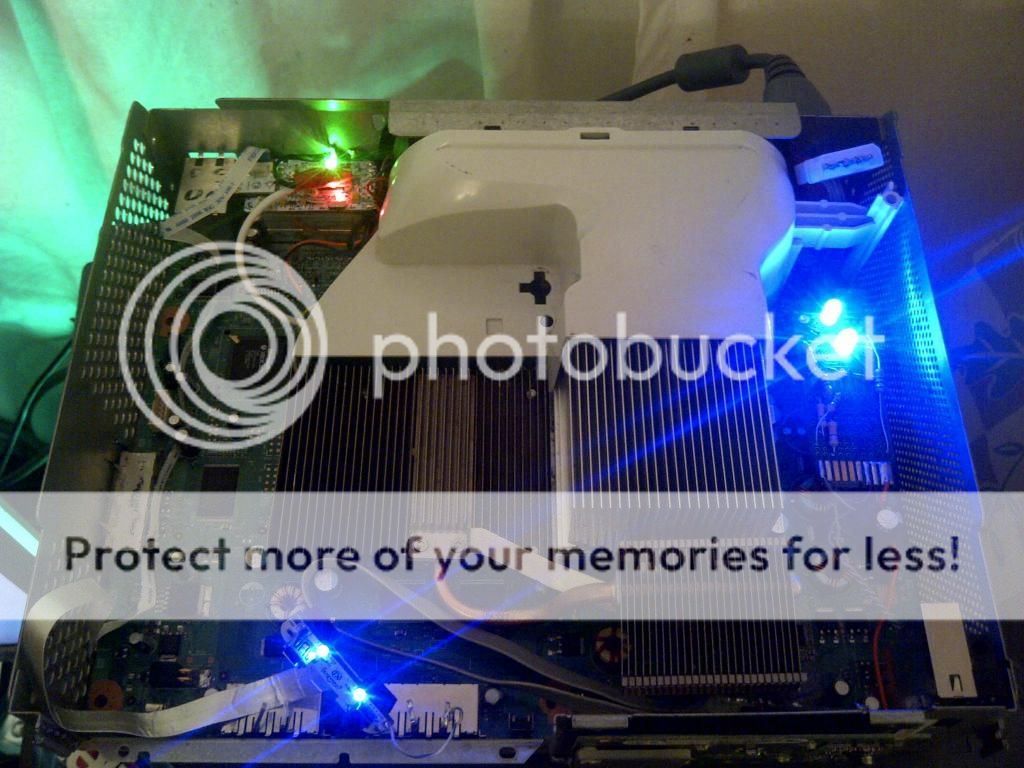

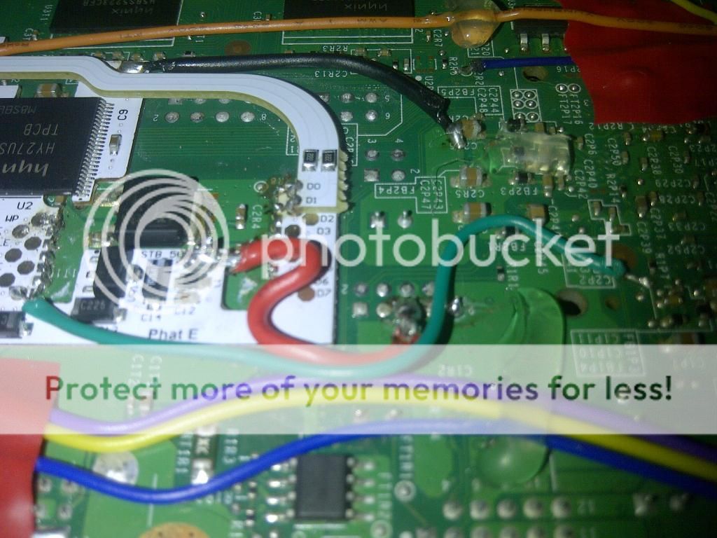

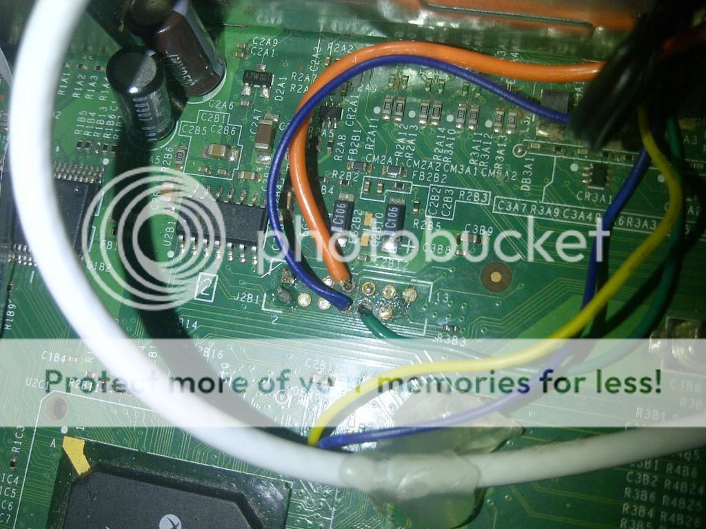

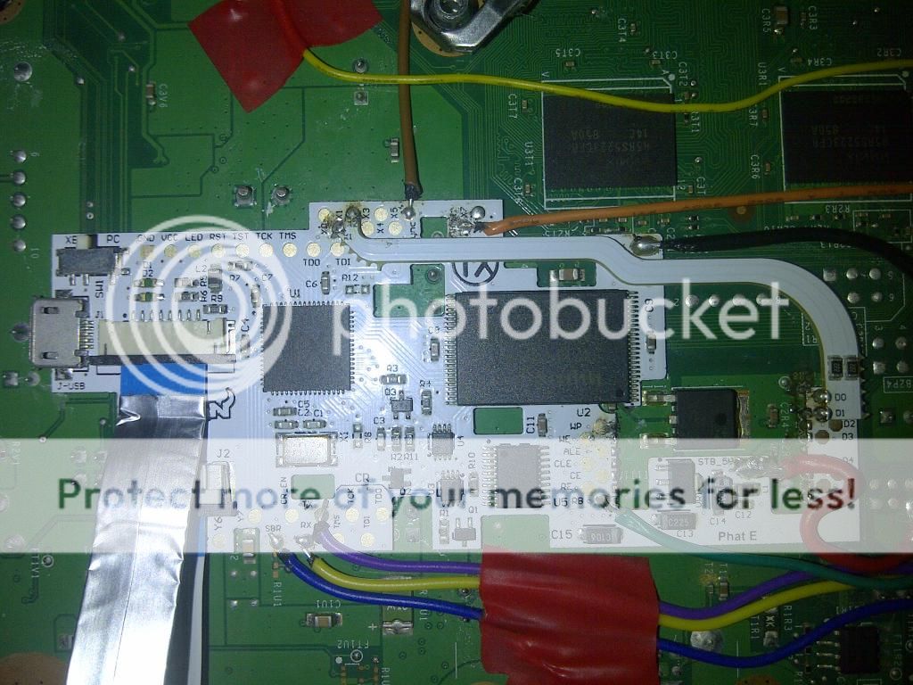

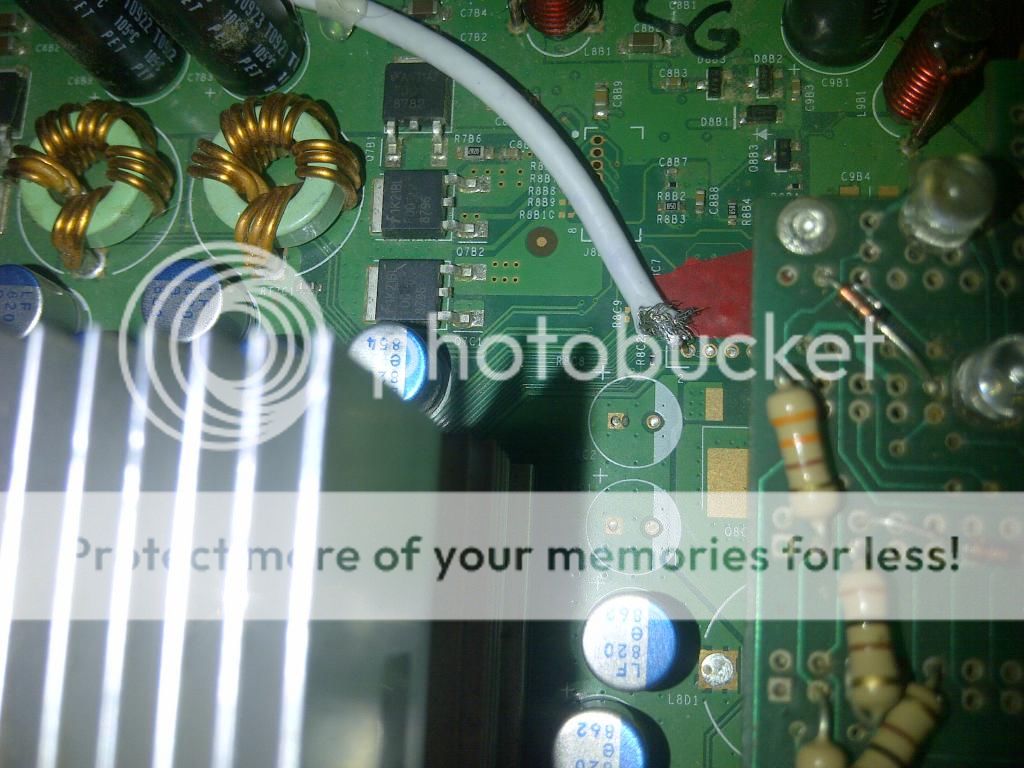

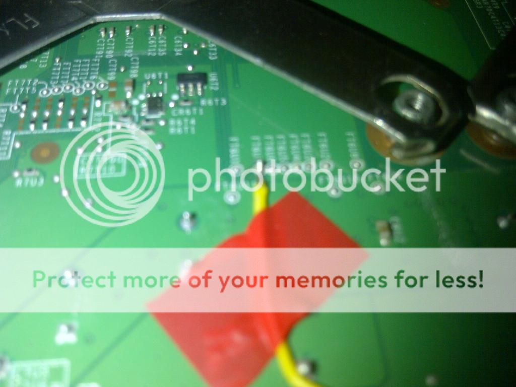

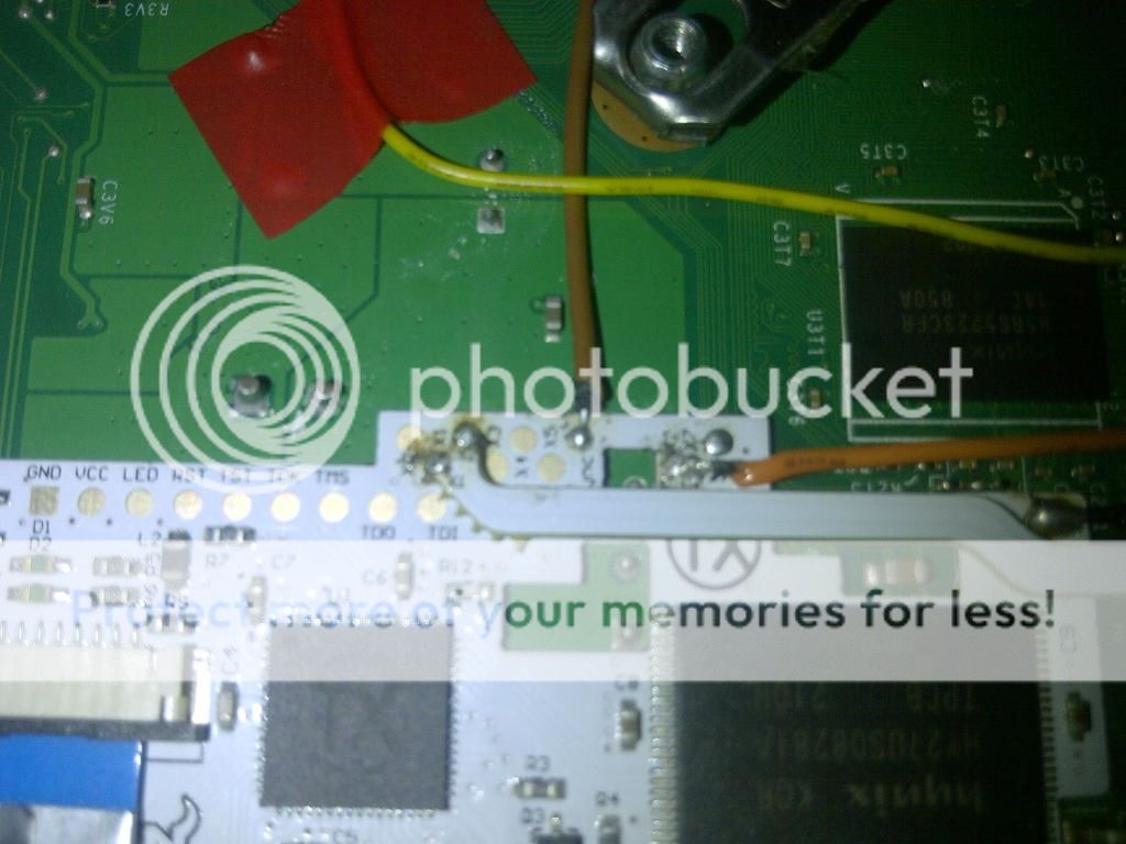

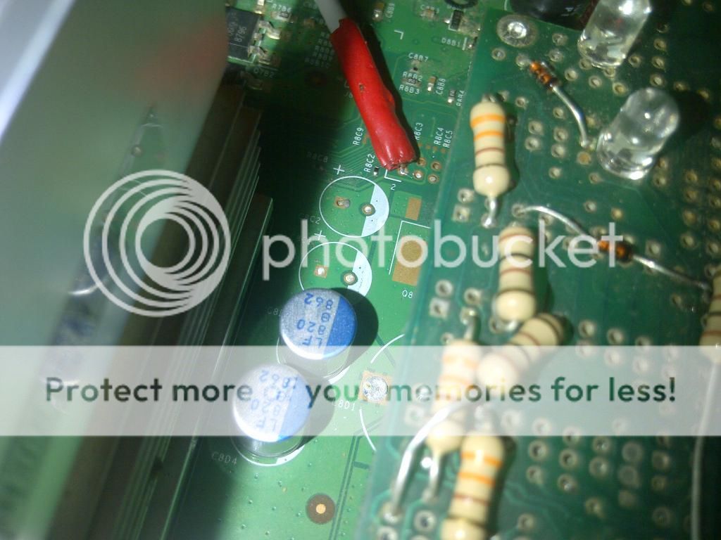

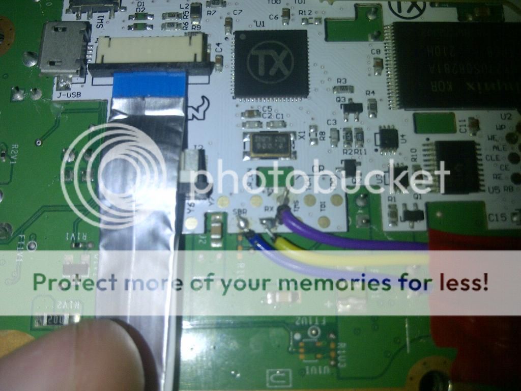

Pics:
Best Pics I can get, Includes CR wiring and DemoN wiring.
Yes, The Green Light is on - Its because I caught this picture while it was flashing.
DemoN Wiring
CoolRunner Rev. C Wiring
FYI! I used the BLUE wire for point F since it didnt come with a BROWN wire for F!!
The CR Ground is not burnt, Its from the flash. I even redid it. And points on the BB Conversion kit are not bridged, its just the pictures. I looked them over with a magnifying glass.
Also, I disabled the CR EN, Flashed a Non-Demon Timing file to the CR, and tried to boot Xell on the Onboard NAND - Hit eject, and nothing happenned. Maybe this will help.
Antalpromille
Aug 4, 2011
3,146
Borås, sweden
Re: Demon BB reading as a SB even with conversion and Firmware update?
im not saying that your soldering is the problem but i can defenitly say that i see big flaws in your solderingskills and your common sence for wiring and installs. you dont think you should have isolated both ends of the low-loss cable? cutting down the un-isolated parts of your other wires etc.? and do your self a favor, get some good flux and learn how to use it.
You have the 'F' wire soldered to the wrong point on the board. That's 3.3v switched. I'd be surprised if you've not damaged the coolrunner already.
Reactions: GModz Tuts
GModz Tuts
Feb 20, 2013
Broomfield, Colorado
This I do, Thanks a Ton martin C. I have done a bunch of RGH installs and never done that, Im surprised I did, and Also surprised I didnt catch that. I hope the CR isn't burnt up,Its a brand new one. Am I ok so assume the CR is fine since the Green Light is flashing every 5 seconds?
