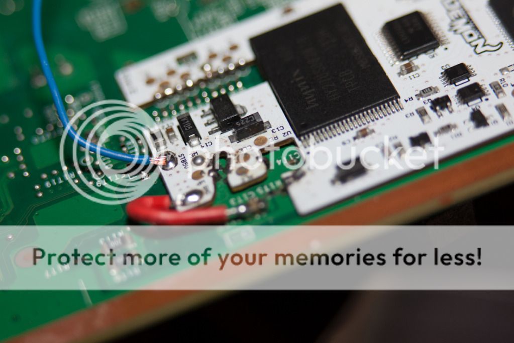

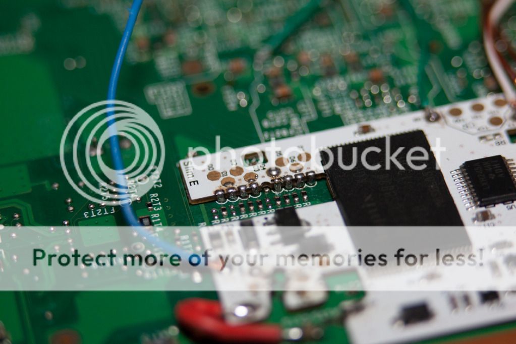

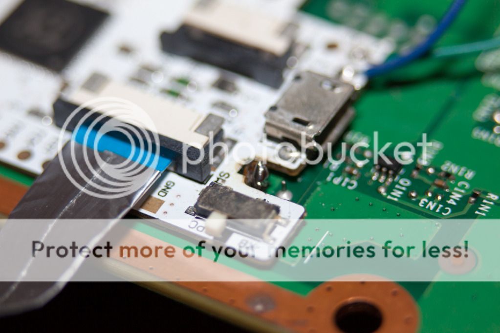

So I am reusing a demon I've had in my drawer for a while.
only hitch with the install is the anchor point next to the swtich, its kind of destroyed. everyother point is on fine.
I am using parallels 2 on a MAC to run J-runner, never a problem in the past with demons or J-runner at all.
turns on picks up in J-runner happy days. reading nand starts
J-runner crashes.
try again
same, and again and again always only when reading mobo nand.
now I just get nothing in J-runner at all, no demon logo. the switch will also freeze with the LED on and will not switch off untill I unplug the console.
console still boots and will make gltiching sounds when on demon nand so 90% the install is sound.
any ideas?
pics below

it doesn't pick up on XB either.
Switch in pc will cause solar problems as you describe. I learned that the hard way myself lol.
I'll try and find some, only got ethernet wire
I guess the anchor point isn't anything important for a connection or anything?

Try doing a read/write using the demon toolbox software. I had issues in the past with J-runner crashing when trying to read or write the nands. But when I switched to demon toolbox it showed me what the real issue was, "Manufaturer code "xx" not found", or something similar. If you get any sort of AF/AD/EF/etc code in demon toolbox when trying to read/write then it is a problem with the row of quicksolder points on the demon, specfically D0-D7. Check with a multimeter between adjacent points to make sure none of them are bridged. Also check the resistances of all adjacent points and combinations of points (ie. D0+D1, D0+D2,etc,etc). The proper resistance should be around 10K ohms. Although on my last demon install D0+D1 registered at 9.25K ohms, the rest were at aprox. 9.85K+. If your resistances are any lower than that then I found it will cause problems with reading and writing the nands consistantly or cause crashes like you were experiencing with J-runner. Hope this helps in some way.

Also the anchor point that you're referring to I believe is just another ground. On mine when checking with a multimeter that anchor point and ground point would pick up slight continuity to eachother if I'm not mistaken.

ok cool will try that later today. so if the anchor point on the demon is fadged what are my options?

Like I said I'm not too sure what that particular point is for. It might just be another ground. Either way I'm pretty sure that point should not inhibit your ability to read and write the nand. I believe the only points that u need to worry about for that are the cluster of qsb points on the right hand side of the chip and the RB point. But regardless just make sure you have a good clean connection on all points (minus the anchor). Also you should trim your wires down before soldering them to the points to avoid bridging and interference. I'll post some pics of my install for reference.

13,721
De-solder each wire apart from RB, 5V STBY and GND - these are the only wires you need soldered (along with the quick solder points) to be able to read/write to the console's NAND.
You should also set the switch to XB since the DemoN is installed to your console.
When you re-solder SBR, TX and RX, trim the excess off those wires.
