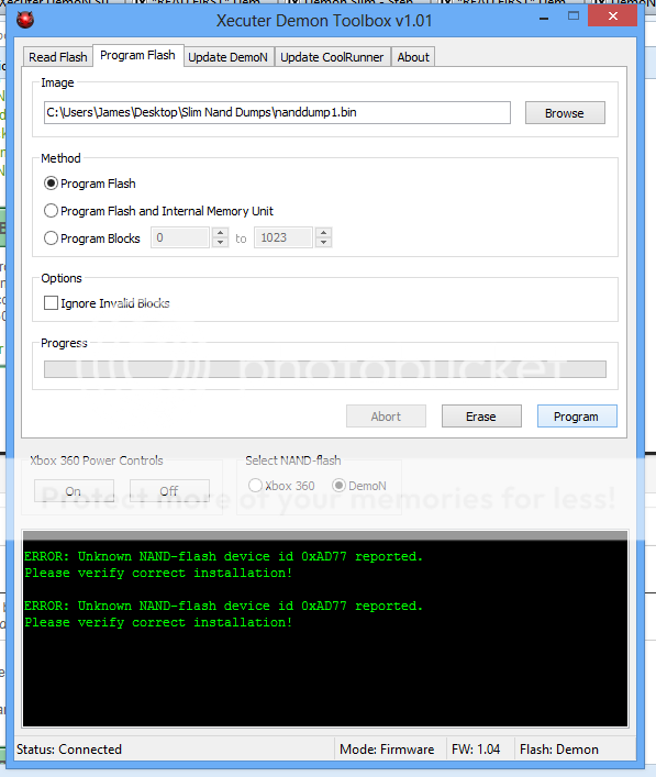

I updated to the latest firmware 1.04 which went successfully. Then I tried to flash a nand to the Demon (not installed) but get the message
ERROR: Unknown NAND-flash device id 0xAD77 reported.
Please verify correct installation!
The Demon NAND is definitely selected and I toggled NANDs a few times to be sure, I have tried both the on-board micro USB with 2 separate cables and the mini USB on the extension board thing with 2 separate cables but always receive the same message.

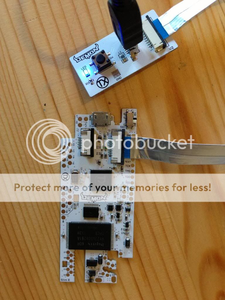

So the DemoN is set to PC and you're using a micro-USB cable connected directly to the DemoN PCB? Can you post a pic?
Please advise any other pictures you need. Both USB connecting methods result in the same error.
Thanks
I would say there's a fault between the controller and the NAND, causing the ID to be wrong (should be 0xAD73). Contact your reseller and get a replacement.

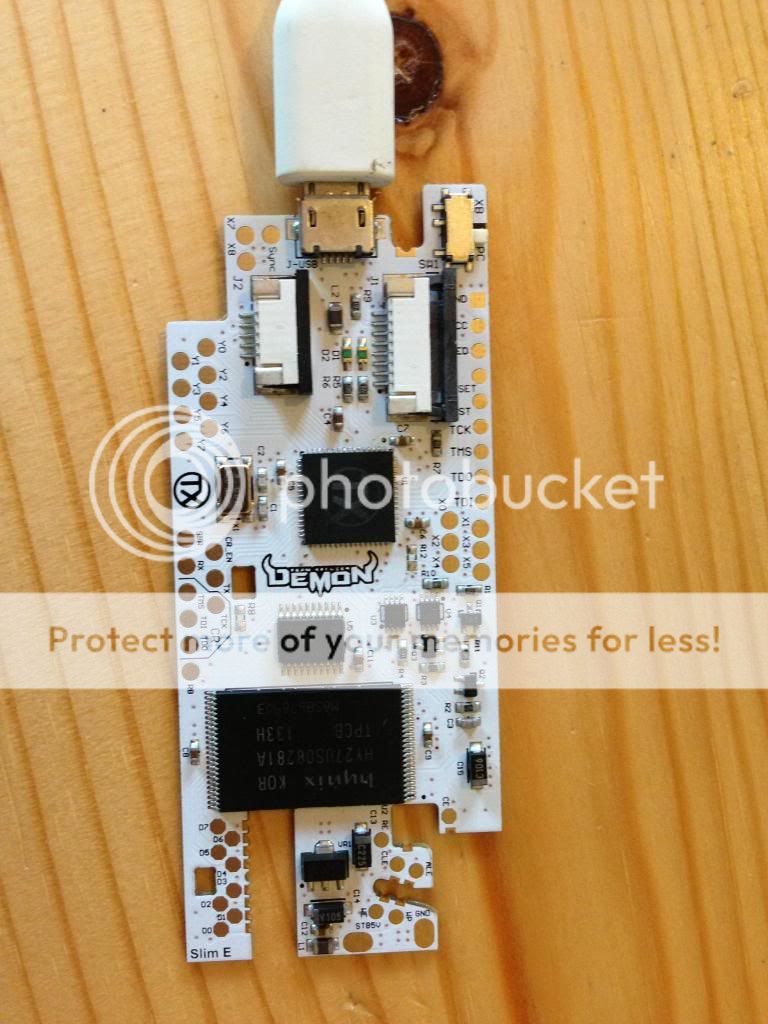

Looking at this Demon board, if you have one on hand could you advise if R12 should be populated? as on this board it isnt. Also R8

EDIT: Looking at this Demon board, if you have one on hand could you advise if R12 should be populated? as on this board it isnt. Also R8
No - they should be as-is AFAIK.

The problem with my Demon is a poor solder joint on the square TX branded IC just in case anyone is interested and has this issue in future
EDIT: a reflow of the IC in question appears to have fixed the issue
