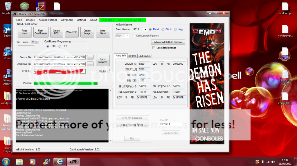

hey guys, i have just finished installing cr revc and demon. i have put glitched image on demon nand, and all is fine, quick boots etc. boot when i try to boot retail nand i get nothing. i have noticed that there are 2 different ldv loaded. 8 and 9 ??? could it be as simple as that? change the 8 to a 9?
have attached image of jrunner.
http://i990.photobucket.com/albums/af24/bigbren2008_2010/jrunner-1.png

Boot to XeLL and combine the number of Fs on fuse-set lines 7 and 8 - this is your console's current highest LDV.
Ensure it matches what J-Runner tells you and if it doesn't, build a new retail image with an LDV increment of 1 (the current highest value you see in J-Runner).

cheers BL4K3Y, i have checked all pionts with my meter and etc and everything checks out, not quite up to par with the software side of things yet. hopefully thats the solution
i got 9 F's on fuseset 07. so i would need to build a retail image with LDV 10 or have i got it wrong?

hmmmm, odd.
i have just been playing around with the console. got the retail nand to boot no problem when i set the coolrunner to prg.
i programmed the coolrunner out of the console with my nandx.
do i need to reflash coolrunner with demon while retail nand is selected prehaps?
13,721
If XeLL says your LDV is 9, then your retail image is fine.
If you have a DemoN installed, leave the CR set to NOR and program an EN timing file to it using the DemoN (remember to solder the CR_EN wire in place too).
