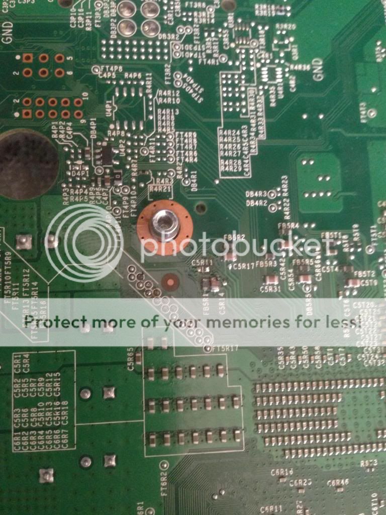

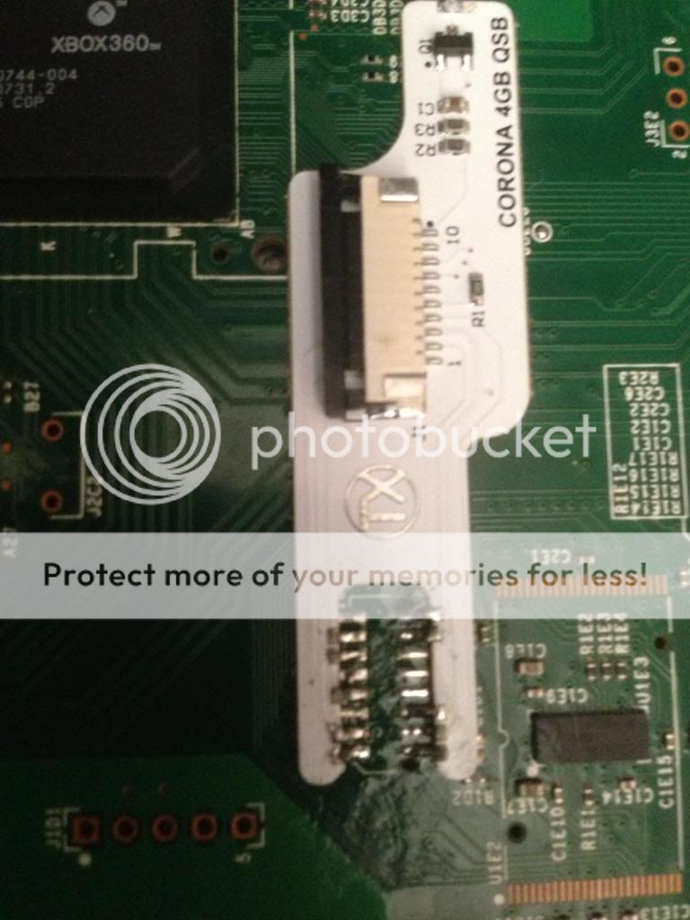

ok so I installed the dgx got some blinks but never got it to boot exell now when the console blinks I just get red ring and error code 0032 I attached photos pretty sure I messed up the point the yellow wire attaches to I tried resolder all the surrounding points to no luck any ideas on how to fix this I have rgh only roughly about 10 xboxs

Why would you try an solder to other points around it? That makes no sense to do. C5R14 looks to be damaged. That may be the reason for the red dot. You might want to attept to repair it or send it to someone to do it for you. Do you make sure that the heat sink has some pressure on it when turning it on? I see you don't have the x clamp on, so if you don't apply some pressure the Xbox will red dot. Also, like Martin said, you don't have pictures of the DGX even installed. Did you flash back the original nand to see if it boots??

sorry I did install the dgx uninstalled for the pictures so you guys could get a better look. I did flash back the stock nand before trying a regular boot when the dgx is wired in no green flashing light and the power light just stays green on the console

also I took the xclamp off for pictures I did have it on when I try to power it on now that you say that the c5r14 does look damage any ideas on how to fix

Does the console boot the stock nand? Or red dot? And You may want to make sure that the cap C5R14 has good connections to the board on both sides of it. In that area you may also want to look for a broken traces.

xex thanks for your help I looked for broken traces have not found any I get red light with stock nand and get green light with dgx but dgx does not flash just stays red with no green light I am wondering about the point next to c5r14 it is a little spot with no label

Okay did you make sure that C5R14 had a solid connection on both sides of it? It looks as though it's burnt up on the top side. You have a corona v2 so do you have dip 8 turned on? Actually you should get your console booting stock nand before you can do anything. My main concern is the cap that looks like its damaged. When you read your nand, did you get two clean dumps? And what is your concern about the point next to the cap?

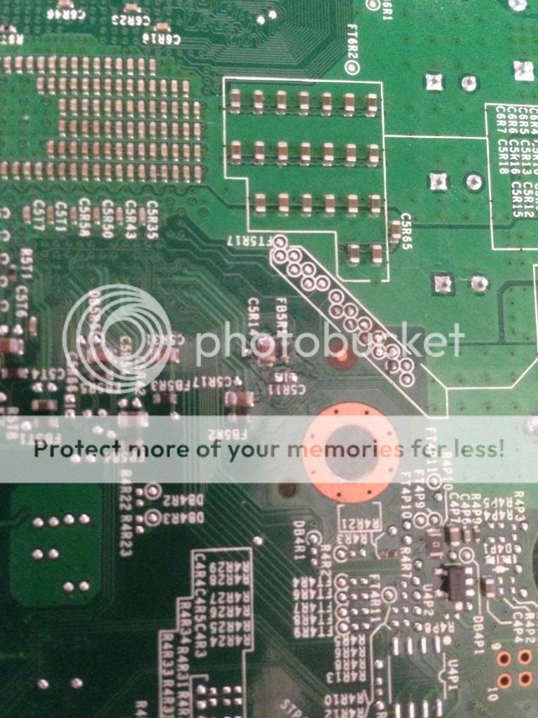

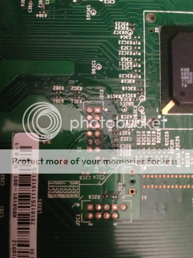

I did get 2 clean dumps and the nand writes no problem here is another picture

and I do have 2 good connections on both sides of the resistor
---------- Post added at 10:55 ---------- Previous post was at 10:53 ----------
it looks to me like the ft5r3 might not be soldered all the way after looking at it from this angle I will also try a continuity test on the resistor

my advice is take the cotton-fiock and alchool isopropyl or acetone and clean well all the places where you have worked.
Just clean, if you have a tester controls the conductivity of the QSB points whit motheboard...
After which with good flux redo the welds to QSB and check after work and cleaned with cotton-fiock etc.. the job done, the DIP-SWITCH DGX1.0S and you'll see that all is well.
