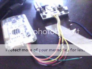

really have to update my nand-x. Got my DVD cable from an old xbox and spare cable from nand-x to be modified.
haha, got it working now to new nandpro 3.0 ;) ;)
**camera from an old cellphone just to upload :)

Looking at noipi's post with pic, is the usb update cable just to supply extra power to the Nand-x then ? I thought it was to flash the Nand-X FW v3, or is it a combination of the two> usb update cable for extra power and the usb that comes with Nand-X for the programming the V3 FW ? :confused:

I had the same issue regarding nand-x not showing in device manager\Not being detected, I also bought mine from Mr Modchips, It seems he ships them blank I.E no firmware on them. Once you get a cable and flash the firmware on the Nand-X it will work fine.
