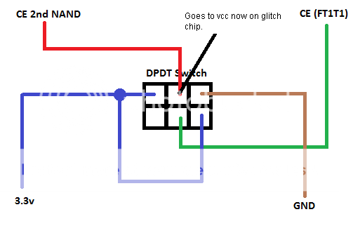

Alright I'm new yes I know, but not a newbie (I'm hoping) LoL
Anyway I have a few dual nand rgh units that I've updated all nandwhich and since the update I cannot get my stock dash to boot unless I disconnect the glitch chip. (only vcc line) Was wondering if anyone else is experiencing this? Both nands work fine, but unless I disconnect the glitch chip the original nand just won't boot.
Nothing has changed besides the dash updates to 14717.
---------- Post added at 00:28 ---------- Previous post was at 00:26 ----------
At the moment I'm assuming I have to wire in a different switch to control the glitch chip being on or off, or just a whole new switch to do it. Either or it looks like it's my only option at the moment.
