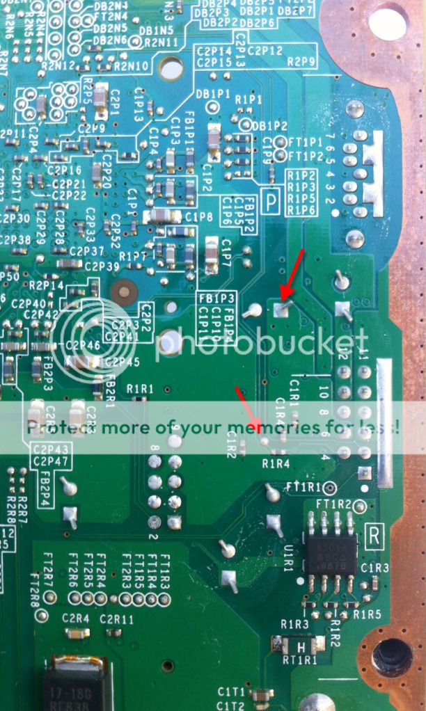

Thanks for the suggestion; it didn't work for me, but I am still looking into a solution.
I disconnected everything from the motherboard, and turned the Xbox 360 on. The green light (in the centre of the ROL) still flashes even when there is no DVD or its cables connected to the motherboard.
I am going to try the solution from daman10 (bridging the two points). I'll report back and give the result.

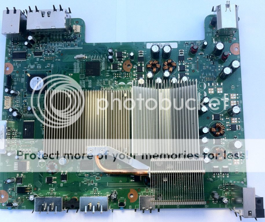

if the green light in the middle of the ROL keeps blinking and the drive just ejects all the time the yes
This certainly stopped the blinking green LED in the centre of the Ring of Light. I have uploaded some extra pictures to help others find the location of the two points that need to be bridged.
