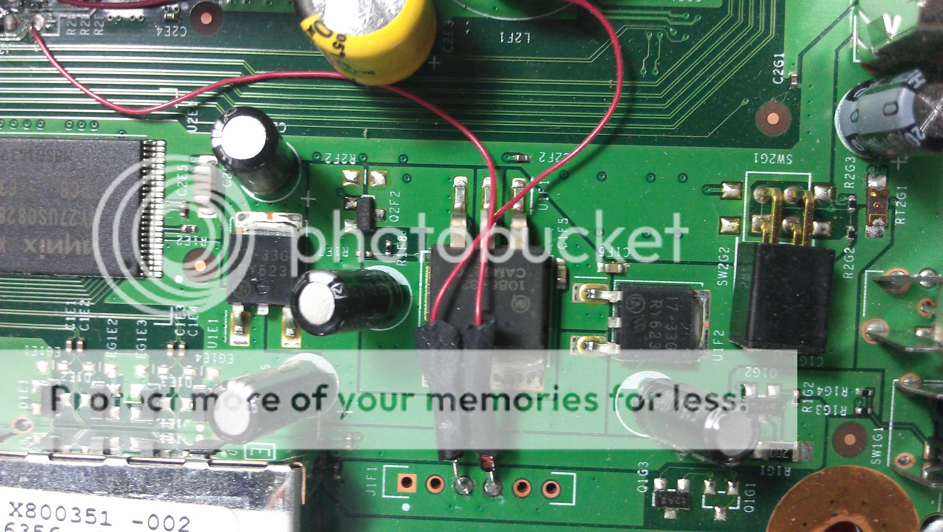

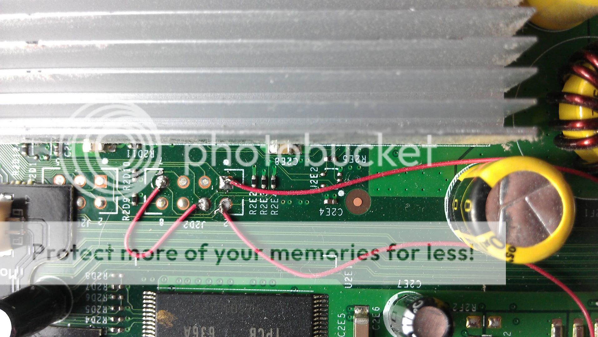

Ok , I have a Xenon console with Blades Dash. updated to 7371. got to matching nands... 2 bad Blocks,.. Remaped blocks using XNand Healer.. Flashed with xell , E71... Flash with XNand full Logo Boot then pause E71???
Any Ideas.. I've been reading and reading and can't find anything to work...
Thanks for any help or Ideas
Just make a new freeBOOT image and write it to the console. See if it works then.
There is nothing wrong with the Jtag wiring as XeLL and freeBOOT work. Like I said, make a new freeBOOT image and write it to the NAND. See if the error goes...
