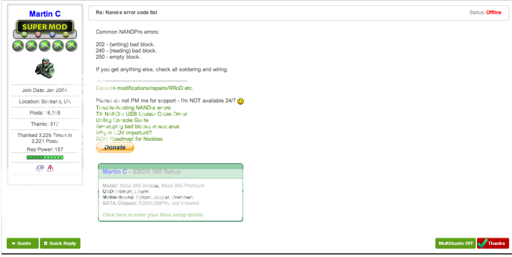

Hey there,
I'm borrowing this from Martin.
Have you tried reading the NAND from Nandpro itself, with a NAND-X?
(Small block 16MB NAND) nandpro usb: -r16 nanddump.bin
(Big block NAND) nandpro usb: -r64 nanddum.bin
What kind of motherboard do you have? Is it a small block NAND?
As the other gentlemen have asked, pictures would be beneficial. :)
Also, read this. ;)
http://www.team-xecuter.com/forums/showthread.php?t=76014
Reactions: jallajalla
